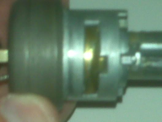

1. Pop off the plastic sensor that surrounds the key by taking a smaller flat blade screwdriver and putting it underneath the wire connector and between the metal lock body and plastic ring. Carefully twist forward till it pops off.

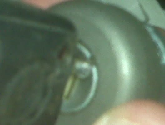

2. Turn the key to the 1 position
3. locate the the tiny hole at the edge of the key slot
4. find a nail that will fit in it but that's not flimsy and about 2.5" to 3" long
5. By hand start pushing the nail into the hole firmly and if you're lined up it should go in at least and inch. If you can't get it that far by hand take out the nail and double check your in position 1 and try again.

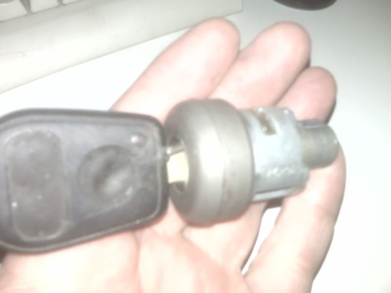

6. If it does go a ways in by hand then grab some pliers and firmly push it in harder. At this point take the pliers and grab around the tumbler and pull it out.
The paper clip may work but it's easier with the nail. I also tried using a small allen/hex key but it didn't work for me. They trick is to have it lined up in the 1 position and press the nail in firmly.
Lastly do not take out the nail until you're ready to put the tumbler in the new lock. Once you put it in the new one the ring will lock back in and you can then pull out the nail
The sensor ring just snaps right back on.

After I picked up the parts today I excitedly drove the wife's Volvo Wagon home and changed clothes to put it all back together. While getting into the car the new ignition lock fell out of the box and BROKE............ When I say broke I mean the piece that holds the column lock down popped out... So I put it back together and re-assembled it with the ignition switch to see if it was o.k.. Unfortunately it would spin backward if I tried after the key was first put in. I then figured maybe it was a fluke and re-assembled the lock to the column. I even put on the snap ring. This time the key got stuck again........
