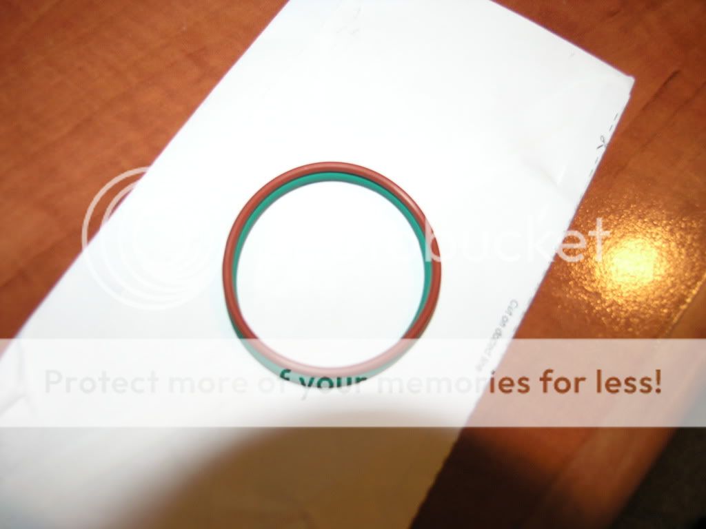

Originally Posted by champaign777 View Post
yaaa bad guy
here we are :
Metric
inside diameter x thickness = outside diameter (in millimeters)
dealer o-ring : 50MM x 3.5MM ( GREEN COLOR ) = 57MM outside ( updated for bluebee -> M52TU #11617504543 )
chemgigi o-ring : 51MM x 2.5MM ( RED COLOR ) = 56MM outside ( updated for bluebee -> M54 #DO NOT EXIST)
Final decision will be done directly on DIZA ( this weekend )
finally i replaced my DIZA o-ring
The green one ( dealer o-ring from < 2001 ) do not match , no way, its too big for M54 DIZA
The E-BAY chemgigi o-ring match perfect
and to remove the old o-ring was a PITA job
