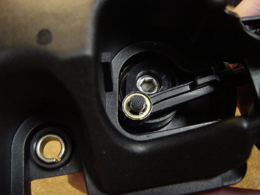

I think your instructions are great. The blurriness is a bit irritating on the eyes but nevermind
One final quick question: The retaining clip on the bellcrank pin. Since the pin is now metal and hard, will this clip stay in place well enough? Or will you be machining in some notches or something?
Originally Posted by BikesStillRule View Post
You can now put the vacuum pot lever back over the bellcrank pin and push the retaining clip back on.
