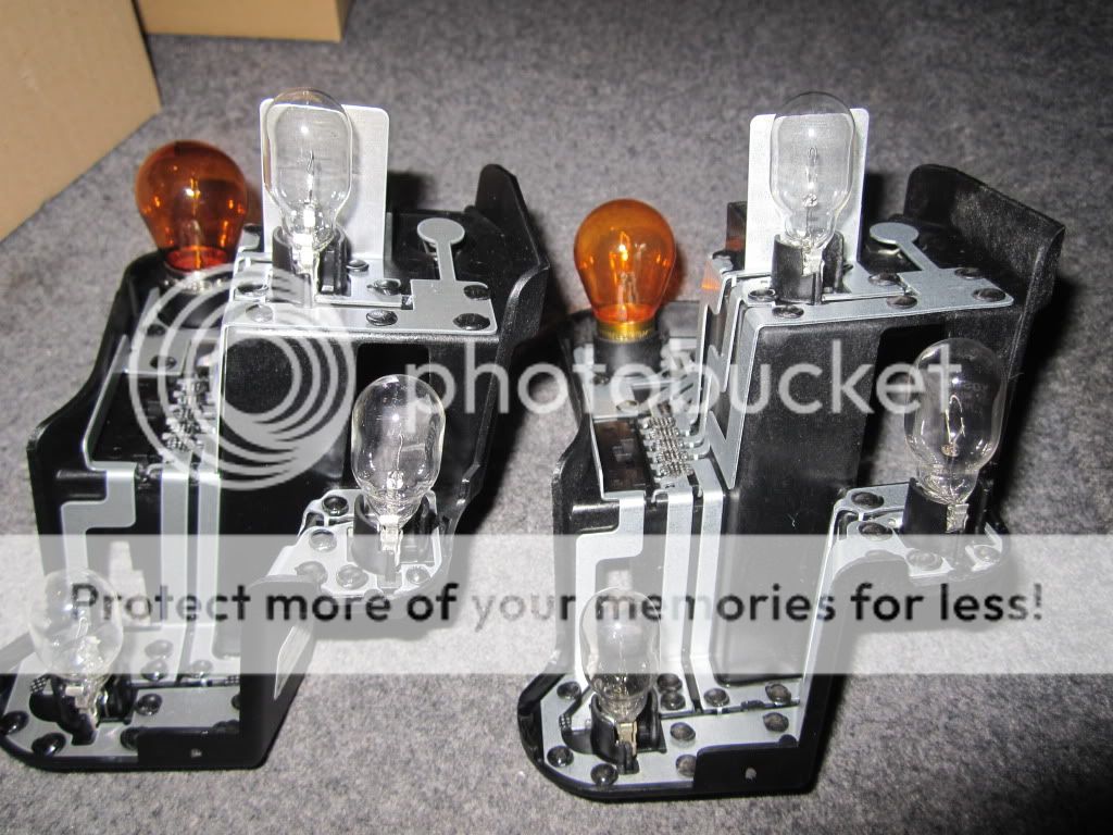

The two sockets arrived today. I installed just the right one first, and I think Bcube's far fetched memory > my research. The code disappeared. I went ahead and put the other one in too, why not. For anyone in the future who finds this by search, have no fear, this is the easiest thing ever, much much much easier than you would imagine. I think the entire swap could be done in 10 seconds with a little practice. Yes, THAT easy.
The replacement right (outer) socket is on the left. I think the build date said something around late 2010 on it.
To install, all you do is remove the cover/liner over the battery, and it's all exposed. That plug's tab really can be a bit of a pain to successfully depress enough for removal. The white tab in the middle right of the panel is what secures it all, and all you do is depress to release. The only word of warning is to check that it's snug after installing, by simply pulling. The last time I fiddled with it, I failed to so, and well, with about 100 miles driven, everything was fine (the socket didn't fall down). It was only tonight when pulling out the old one that I realized it, after it just came out with no effort. After reinstalling the left side, I confirmed that this is something to double check because there is no "click"; the only real confirmation I could get for myself is to simply tug on it.
