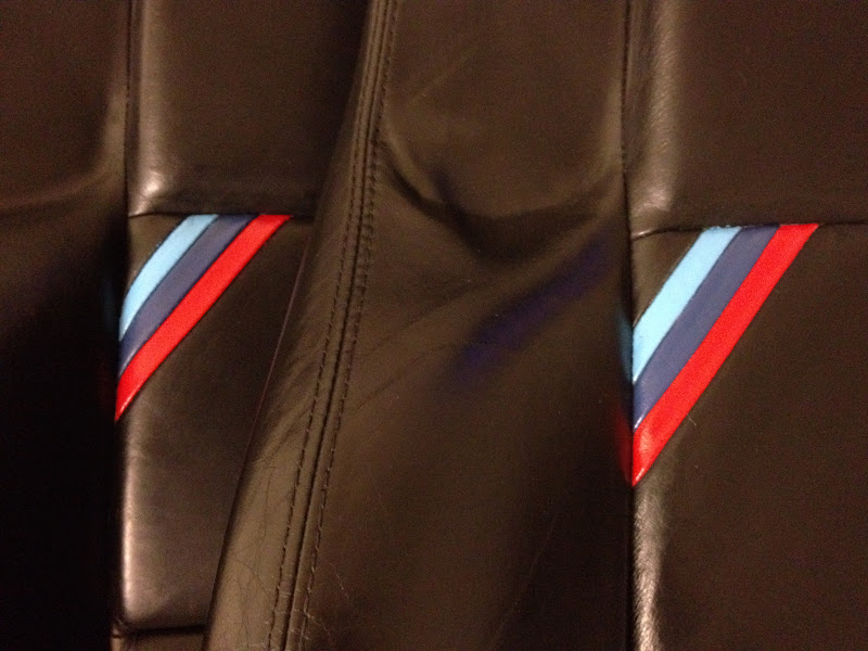

I ordered a 2oz bottle of BL02 (baby blue), BL06 (blue), and R04 (bright red) from Furniture Clinic. The center stripe ended up being a mixture of about 75% BL06 and 25% R04.
I also repaired the cracks in my stripes with the heavy filler cream from FC, then I used their Matte finish sealant/top coat applied with an airbrush in 3 coats.
Here are some additional pics. The matte finishing coat is currently drying. Final pictures to follow after assembly.
