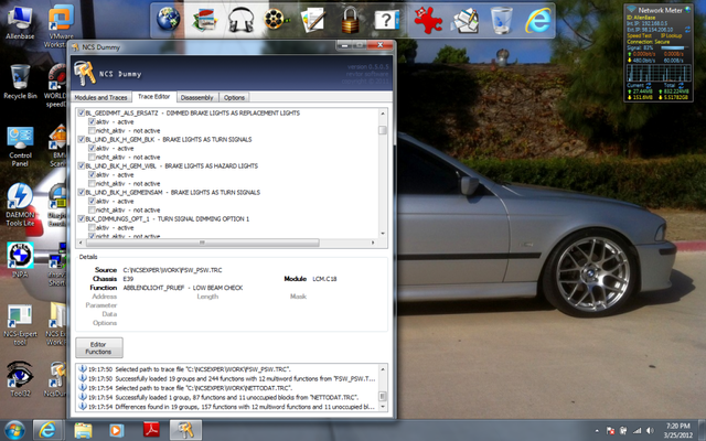

A question for my touring brothers out there. I have been looking into upgrading the tailights (euro ver) on my car but have not done so due to the configuration of the US LCM where the brake and turn lights act as one. I actually had time today to play with NCS Expert and found the following trace.
Has anyone out there tried to change these settings to see how the light output will change? Wondering if anyone out there has messed with these settings before. Also, there is a option for LED tail lights, so I guess I can just set to active for the celis type lights?

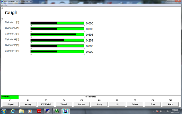

While practicing with INPA found this screen as well. Shows rough on 2 cylinders but just changed plugs 3 weeks ago and car actually runs very smooth. Vanos readings are all within parameters as well.
Try changing the plugs again? Maybe a coil or two?
