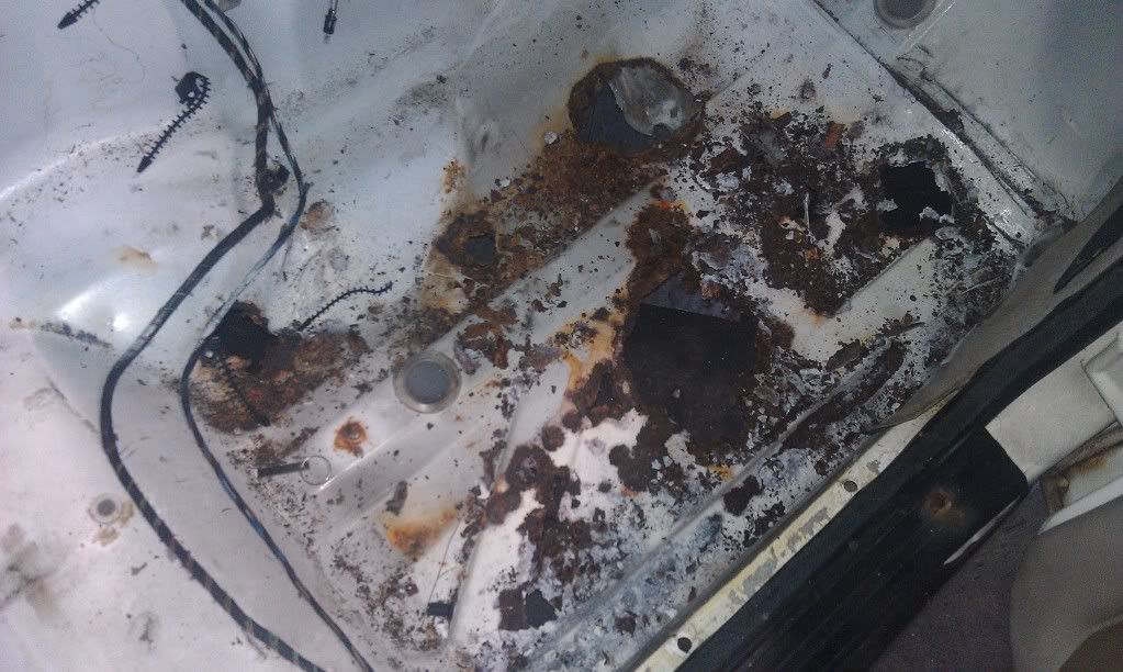

Then did some hobo floor repair. Cut out the worst rust, then cut and screwed down an old real estate sign.
I finished it up by covering it all up underneath with fiberglass. Later I'll undercoat the top, then the bottom after I sand the fiberglass.

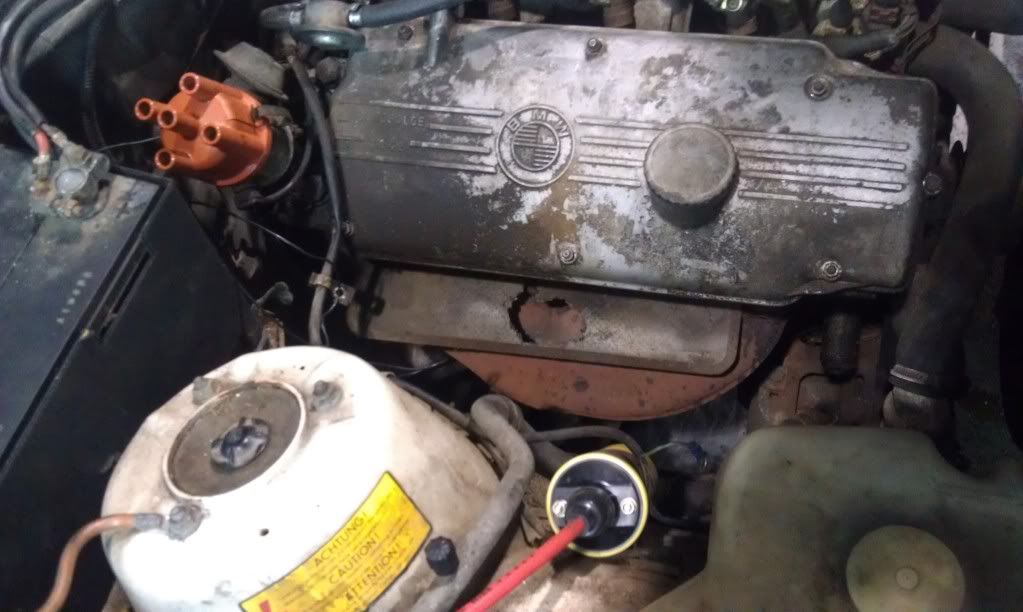

Then I gave the engine bay and under the engine a quick clean. I'm trying to locate my oil leak. I think the majority is the valve cover gasket so I'll have to put one on order.

Nasty floor
