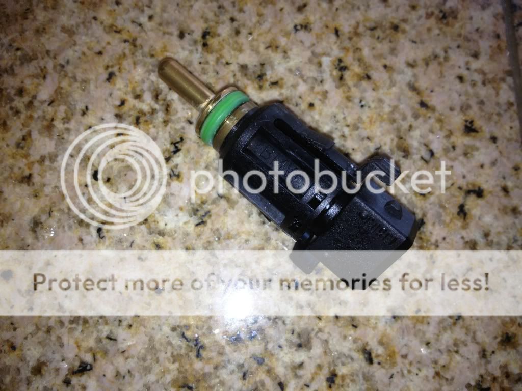

Originally Posted by pmpn8ez View Post
You are exactly right. Went to buy the hose and the parts salesperson recommended same part instead if the hose. The rubber washer is known to wear and cause to leak coolant. Unfortunately they do not sell just rubber washer. I bought the sensor with new washer. $45. Pix of the old temperature sensor.
mine is doing the exact same thing.... Im fixing it this weekend....
