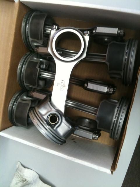

Eagle H beam rods after I installed them on the pistons with the Grant rings. I did have to file the end gap on the rings, they were a little tight for my taste at about .012 so I filed them to .020

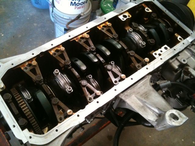

Nothing unusual about the bottom end... assemble and torque to specs.

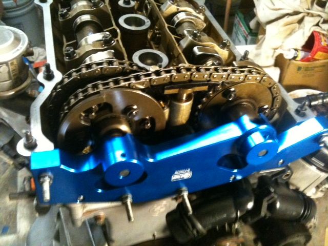

The Vanos tool kit is absolutely essential for this build... there is NO way to set the timing without it!

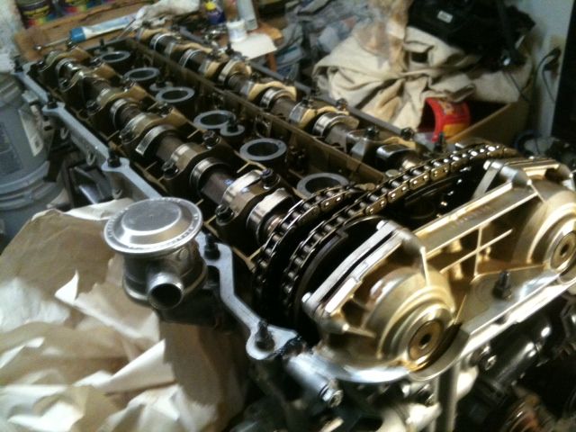

I dropped it in this afternoon... tight fit!!
