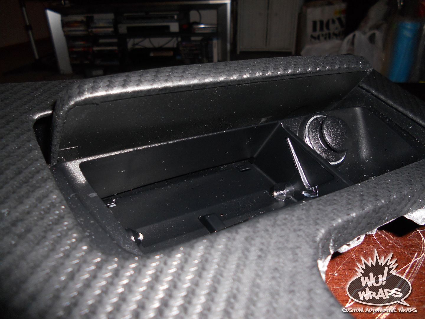

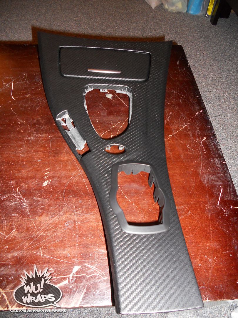

sup sup, finished this up last ngiht, bme e92 m3 center console wrapped in carbon fiber fabric matte black from www.pyspeed.com. believe it or not this part took 3.5hrs to complete! 1st have to remove the oem wrapped leather, then sand the hell out of it with a 50grit sandpaper, wash it, dry it, cut my materials, and finally glue on the carbon fiber fabric and trim... reason for using the fabric as opposed to the vinyl is that the bmw e92 m3 usually comes with the optional carbon fiber leather trim. however they do not offer the center console as a part of the trim. the cf fabric is the closest match to the OEM stuff. this is a out of state job from san marcos cali. packed and shipped back today. owner is diggin it from the pics! Wu! Wraps
