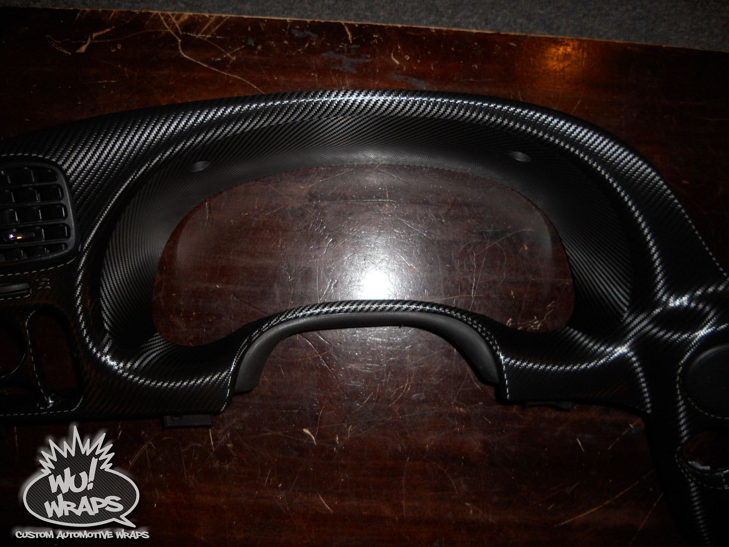

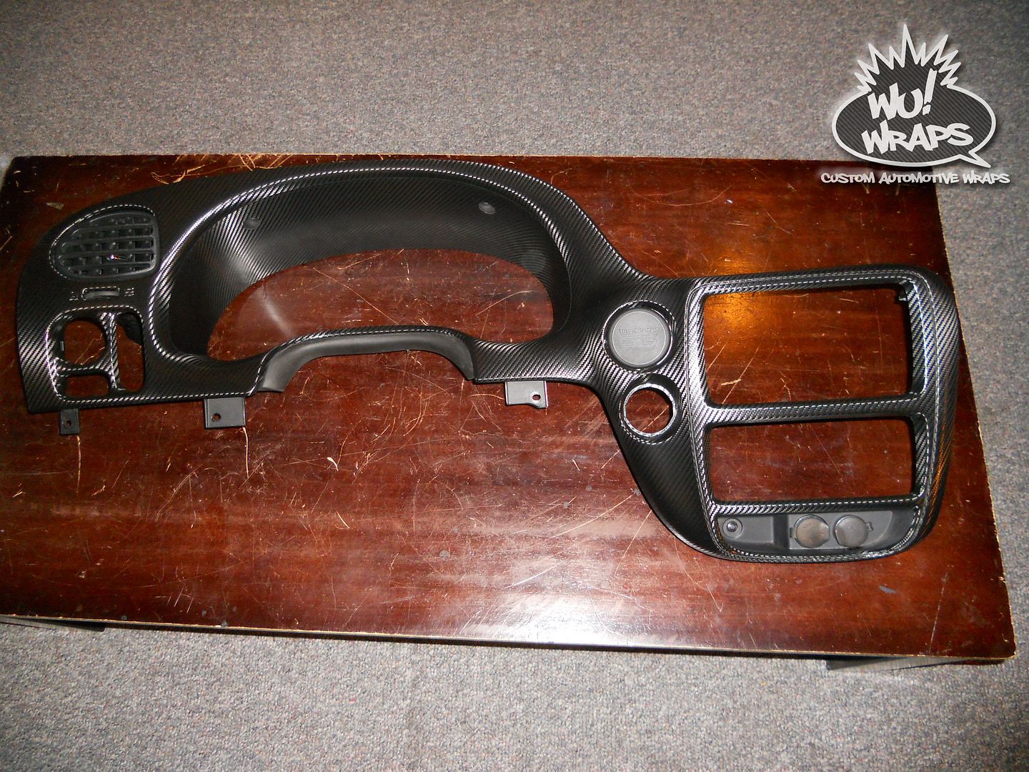

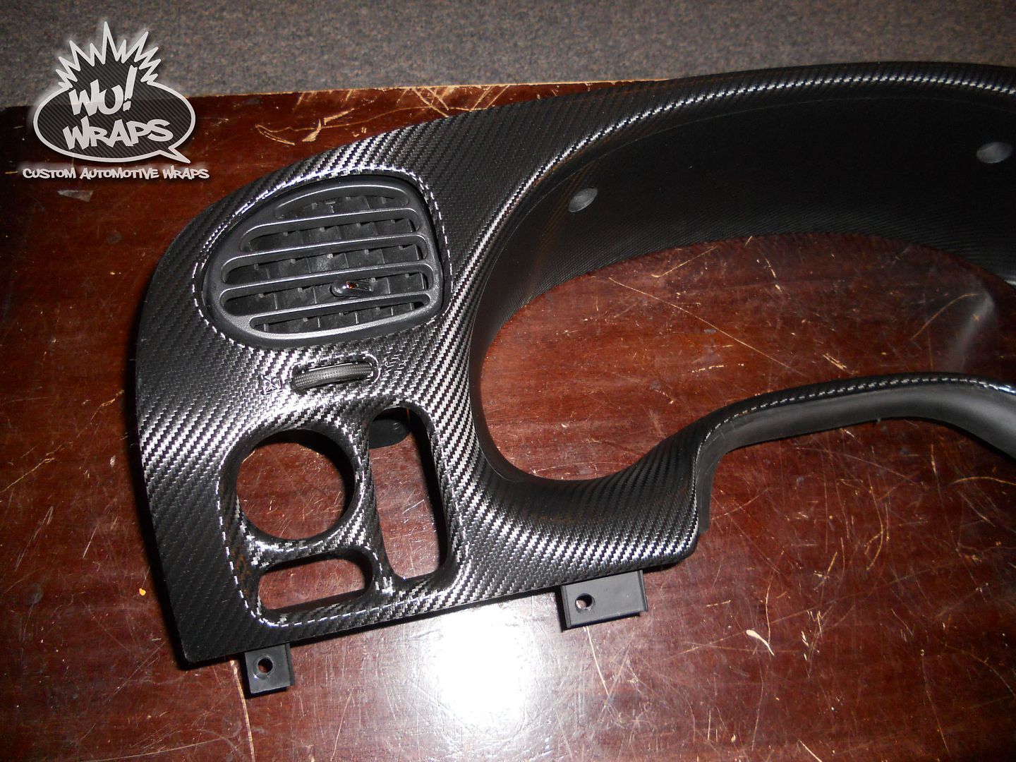

sup sup, another out of state job mailed in today. Chevy trailblazer interior trim in 3m 1080 carbon fiber. did one a while back, this guy must've seen the other one prob on a forum. word spreads fast these days! so waiting for some window control trim parts and gonna get this back in transit to MN. lots of 3m primer 94 around the rounded edges around the radio area, the rounded dip by the ignition, both recessed round bezels, and the 90 degree bends around the radio & climate control area. gotta be real careful how you stretch the vinyl to come around the 3 corners, too much stretch can cause a shiny spot, tear, or wrinkles in the vinyl. this is where technique comes into play. overall came out great! this took about 2hrs to complete. Wu! Wraps
