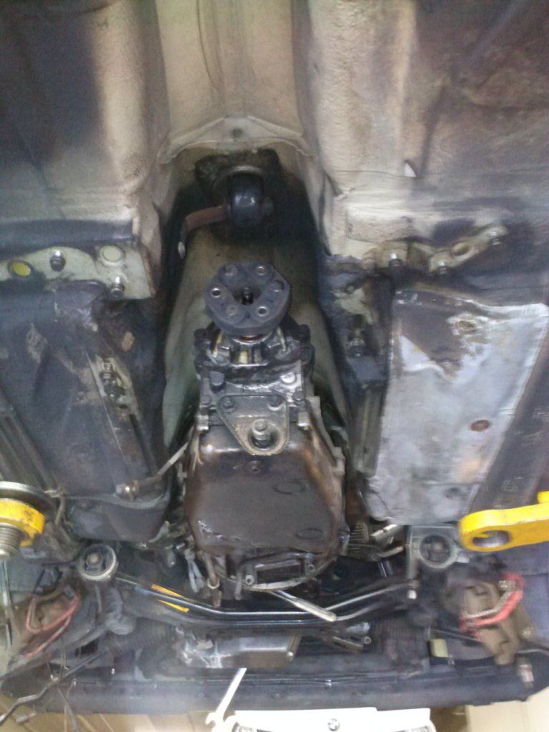

Last Saturday, my guys at the shop volunteered to help me out and get the 4dr track ready for Homestead next weekend. So, swapped in a manual, made coils, changed the brakes, flushed the g260 with Redline.

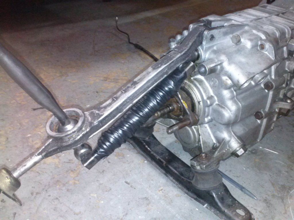

Saw this mod on a website. Wrap your selector with solder to weight it. Can't tell if it did much because I also made brass bushings for the lever and installed a short/short throw lever.

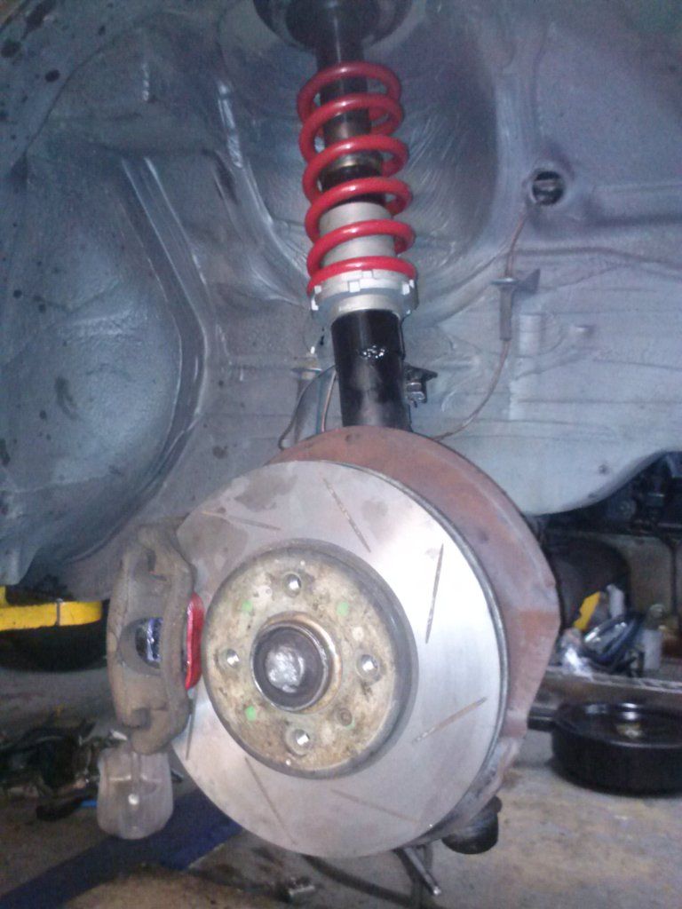

Slotted rotors, Pagid Red pads.

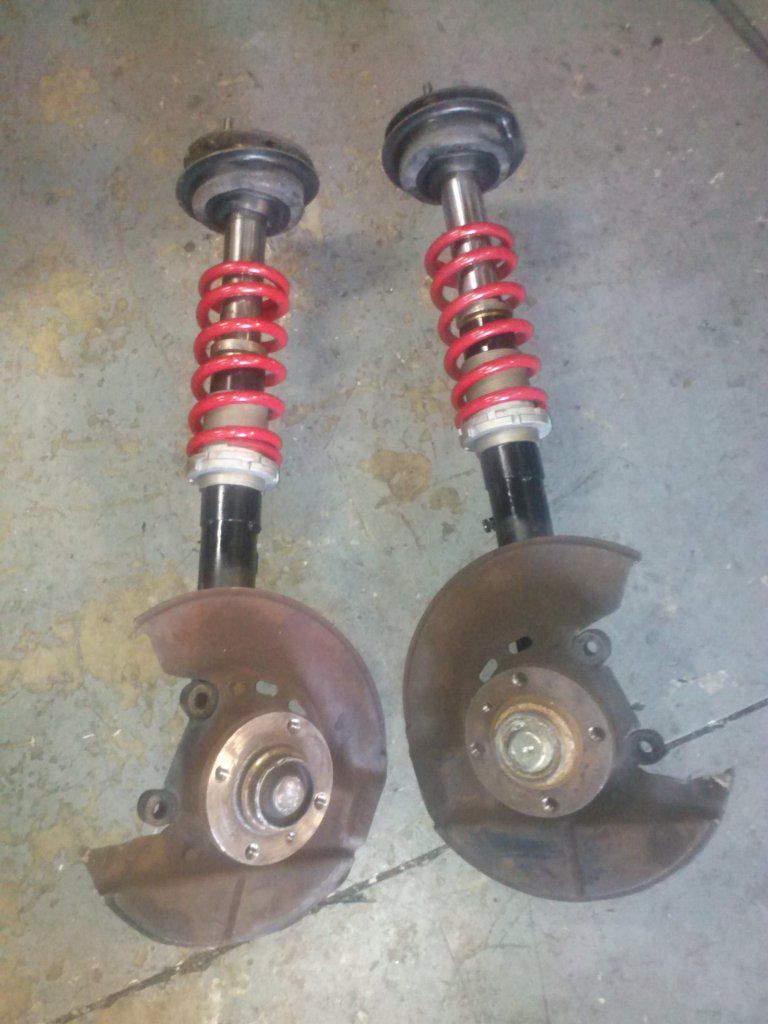

Had to use my old XXR's on the front. The 205/60 on the weaves almost touched the strut tubes in stock configuration and rubbed once I put on a new sleeve for the spring adjusters...
Now you don't see it,
...and now you do.
