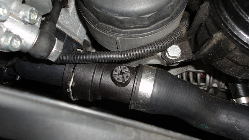

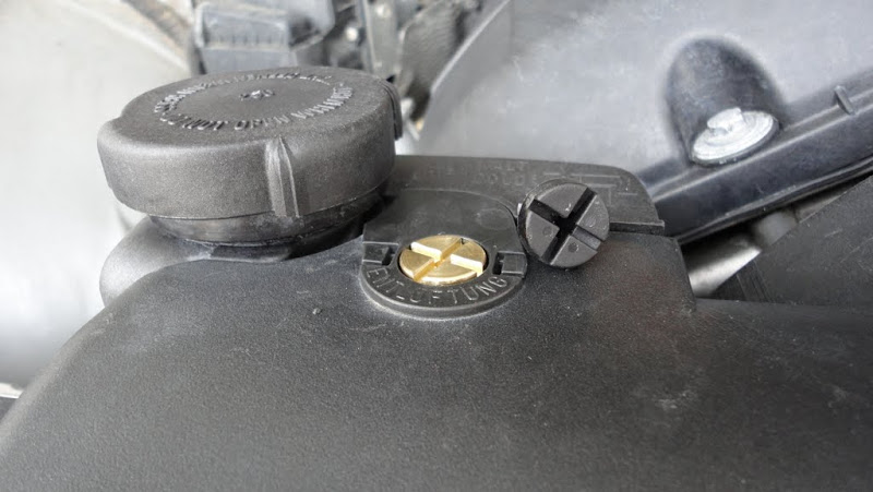

This one's for you Bluebee. I could elaborate here but it's mostly self explanatory. Had a bleeder screw fail completely last week. Ordered these from OEMBimmerparts.com and installed today. Took about 2 minutes. Cheers!

niceeeeeeee................but on hindsight...now that the bleeder screw is strong-er....wouldn't there be a possibiity of the PLASTIC threads on the radiator side stripping?then we'd have to make brass radiators....brass thermostat housing....brass etc etc........and finally a car made of brass.....oh those german engineers.......!

LOL yeah my indy said the same. This one is surely up for debate but I can at least sleep easy knowing my bleeder screws aren't going to fail.

I also have the brass bleeder screws. I ordered them to get free shipping on AutohouseAZ on $50+ orders, they are much stronger then the plastic ones, but then again I do not consider them an upgrade to the weak system.

As long as you don't over tighten the brass screw you won't damage the threads in the plastic. Don't know if there is a torque setting for the screw (don't really care). I just turn it until the screw just starts to compress the o-ring then another 1/4 turn.

BTW, one thing you've confirmed with those pretty pictures is that the length (i.e., the bite) appears to be the same (so that contention by someone that the brass 'bites' better, isn't apparently true).

Hm. Just did my CCV and VANOS (22 hrs of cussing) and my brass bleeder screw O-ring is similar in shape to my VANOS O-ring-that is, it's not round. Replaced the plastic screws in October, at 168,000km. Now at 173300. YMMV.

How did yours "fail completely"? It looks in tact in the picture.

Doh, just had a bleed screw go out on me yesterday. It went to pieces with little or no force. Temporarily replaced with a rear hub/bearing bolt shortened and wrapped in PTFE tape.

That was the replacement my indy hooked me up with to get me back on the road. The original one (from a 6 month old expansion tank no less) broke right at the top and left the threading in the expansion tank. I couldn't get it out but my indy did fairly quickly.

Gotcha, kinda like they way my expansion nipple broke off for no reason. There is definitely something up with the type of plastic that they used for these things.
The brass should be better as long as you take your time installing it and don't ever touch it again....I'm sure the plastic threads will strip in a heartbeat.
If this "rear hub/bearing bolt" is a good fit, it would be useful, in the future, to point others to it - for the emergency run to the stealer to replace a broken bolt.
For example, when mine broke in half, I hitched a ride with a friend instead of driving my bimmer to the stealer for the replacement. Had I known of a temporary bolt that would fit, I might have saved the now-owed favor.
But ... I'm confused by your suggestion as I don't know 'which' bolt you're talking about.
Would someone kindly post a picture or diagram pointing to this reputed near-fit for the bleeder screw for temporary fixes?
  #25
Old 06-07-2011, 07:51 AM
Shires's Avatar
Shires Shires is offline
Location: Dublin, Ireland
Join Date: Mar 2010
Posts: 169
Mein Auto: '03 E39 520I 2.2 M/T
For example, when mine broke in half, I hitched a ride with a friend instead of driving my bimmer to the stealer for the replacement. Had I know of a temporary bolt that would fit, I might have saved the favor.
I used part number 3 on the below diagram. However, it's definitely not something that you want to take off your car. I had some lying around because I keep old fixings for hack jobs like this. realoem.com says this is a M10X1X31-10.9.
It works for the bleed screw at the thermostat but not on the radiator neck as the bolt head does not clear the fan shroud.
