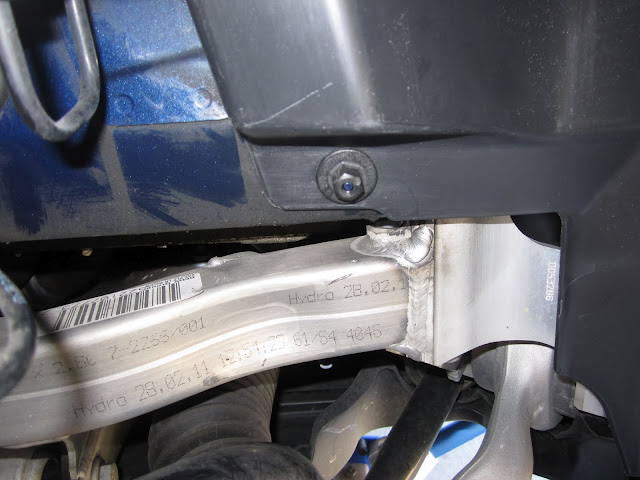

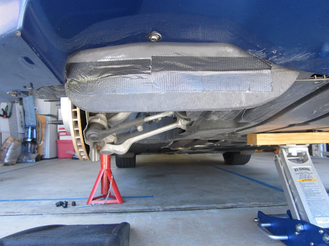

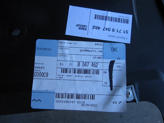

Fender Liner Removal and Replacement
I replaced the right front lower fender liner this afternoon (or as BMW calls it, the "Lower Wheel Cover Housing") just to replace the ripped front deflector lip. This was done on my 2011 335is Coupe. This should be the same for any other E92/E93 with an M Sport front bumper and may be similar for other E9x models. It was a pretty simple job overall. The hardest part is getting the old liner out and the new liner in.
Inside the wheel housing there are six 8mm hex head screws around the edge of the fender liner. There's also a plastic 10mm nut that screws onto a small fixed stud attached to the chassis that's painted body color. This is on the lower inside corner of the liner. If you have an oil cooler in the right front wheel well there are also four screws holding the plastic grille onto the fender liner. The inside lower corner of the grille is also used as a mounting point for the liner, so while you don't have to remove all four screws before you remove the liner, you do have to remove this screw. Underneath the front bumper there's six screws, three in the bottom of the bumper cover and three that attach the fender liner to the front under body panel. The fender liner comes with all necessary C-clip nuts already attached. There is nothing else that needs to be loosened or removed, except for the tire and wheel.
I started by jacking up the front of the car and putting jack stands under the two front jack points. I then removed the right front wheel. All of the 10mm screws were easily accessible and I used a small electric screwdriver with a 1/4" socket adapter to remove them. Because the 10mm nut was plastic, I used a 1/4" ratchet wrench to loosen it and then removed it by hand. It's probably more important to do this when re-attaching the nut.
Once the nut and all of the screws were removed it was just a matter of prying, twisting and bending the flexible fender liner to get it out. Once it was out I verified the part number that is molded into the inside of the liner was the same as the new liner and then I re-attached the oil cooler grill to the new liner before I fit it into place.
Again, it took a bit of bending, twisting, and force to get the new panel into place. Make sure that everything is correctly in place and all of the screw holes line up before installing any of the screws. There were two areas that gave me trouble. One was the inner edge of the fender lip where the liner slipped under the C-clip that is already there. If it slips under the C-clip you have to pull the liner out again. The other area was where the fender liner attaches to the front under body panel. The liner has to be on top of or behind the under body panel so that the screws go through the holes in the under body panel and screw into the C-clips on the fender liner. Again, if this doesn't line up correctly the first time you have to pull the liner out again.
Once the liner was completely in place and everything lined up correctly it was a simple matter to reinstall all of the screws and the nut and make sure that they were all securely tightened. Job done! All that was left to do was to replace the wheel and tire and take the car off the jack stands.
Front deflector lip with black duct tape used to hold it in place (shows gray in the picture). On the right edge of the picture you can also see the C-clip where one of the 8mm screws was missing:
Front deflector lip after the tape is removed. You can see how much it is torn. We first noticed this after an autocross and was most likely done when running over a cone. (I'm pretty sure that it was done when my wife was driving. ):
Right front fender well after the wheel and tire were removed. You can see the 4 screws that attach the oil cooler grille to the fender liner, and the 10mm plastic nut on the lower left corner of the fender liner:
Close-up of the 10mm plastic nut:
Close-up with the oil cooler grille removed. You can see that the lower inside screw is an attachment point for the fender liner:
Fender well with the fender liner removed. The oil cooler is prominently displayed. You can see the stud where the 10mm nut attaches. The C-clip that looks like it is in between the right side oil cooler mounting bolts is the one that the fender liner wanted to slid underneath. The fender liner has to be on top of this C-clip. You can also see the front under body panel silhouetted in the light. The fender liner has to be behind (on top of) this panel.
The replacement fender liner. You can see the deflector lip on the bottom of the new liner and all of the necessary C-clips already in place.
Close-up of the stickers from getbmwparts.com and BMW showing the part numbers.
Close-up of the part number molded into the part. Fortunately the molded part number on the new liner was the same as the molded part number on the old liner!
The front deflector after the fender liner was replaced. One of the C-clips came off the old liner. The other debris is gravel and various bits of melted rubber from the racing tires that fell out while taking the old liner out.
This is the other piece shown in the diagram above (#14) that I ordered to see if there was any way to replace just this part. I don't know where this is supposed to go but I didn't find anything on my car that looked like this part. It would sure be a lot easier to be able to replace the front deflector lip if it was just this part for about $5.00 instead of replacing the entire front wheel well liner for $48.11 + S&H.
Hope this helps!
