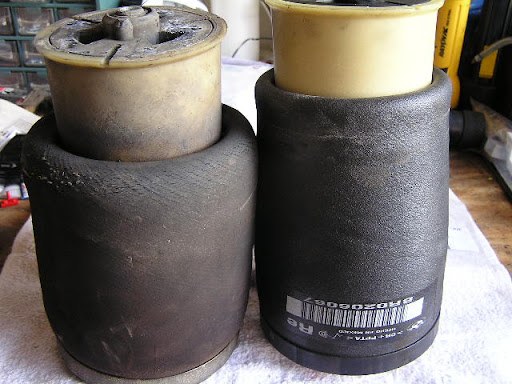

Just an update - yes, it turned out to be as "boramkiv" suggested the air springs had cracked over the time and were leaking to the point every night the SUV's height was dropped by 3 inches .
So, ended up purchasing and installing "Arnott" air springs from carid.com both for $180 with free shipping and Lifetime warranty.
No leaks so far!
ID:	351826   Click image for larger version
