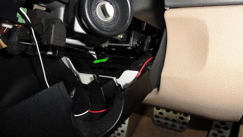

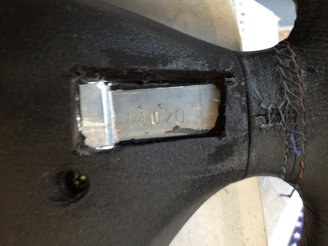

Ok.. wrapped up the paddle shfit install:
Here is a computer motherboard header cable that I trimmed down with my rotary tool to fit on the two pin connector in the CS. I connected the "positive wires" from the paddles to the wires on here to pass the signal to the back end of the CS, where another two pin connector is attached:
I then tapped into the appropriate ground wire on the back of the airbag to provide ground to the ground (black) wires on the paddles.
On the back end of the CS, I attached a length of wire to each of the two leads from the 2-pin connector and ran it through the steering column and down through the console:
I ran it through this mounting whole for the carpeted console sidecover to easily gain access to the shifter assembly area:
Then tapped in to the two middle wires on the forward facing connector to the right of the shifter assembly. This is the group of wires that passes the steptronic signals.
I partially reassembled for testing.. here are a couple videoes of what I found:
I then manipulated the taps to hide underneath the console fascia... it looks well hidden now:
Finished reassembly... and took a fun test drive around my neighborhood!! I love the paddle shifters!
I had done a similar retrofit in my E46, but that included an OEM E46 M3 SMG wheel, so no "hacking" necessary like this time.
2003 530i (Alpine White/Sand Beige) - 18x8.5 & 18x9.5 ACS Type II Wheels - BC Racing Coilovers - Eibach Sway Bars - Beastpower Sway Bar Brackets - M-Technic Replica Bumpers - Slimmbones CSL-Style Spltters - Magnaflow Muffler - Dinan CAI - TopSpeed Performance Strut Brace - Carbon Fiber Valve Cover Fascias - Zionsville Autosport Radiator/Fan Kit - Revmax Stage II Torque Converter - AMG Paddle Shifters
