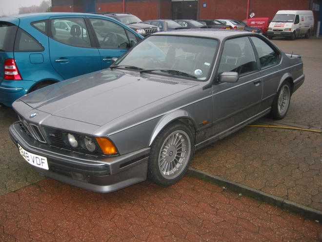

Steve - awesome project, and one a timely one for me. One of my best friends is thinking of this swap, so good to know it isn't impossible! If we start it, I hope you won't mind a few PM's for advice.
As for color, Nogaro silver would be HOT IMHO. Here's a late (and dirty) M635 in that color:
