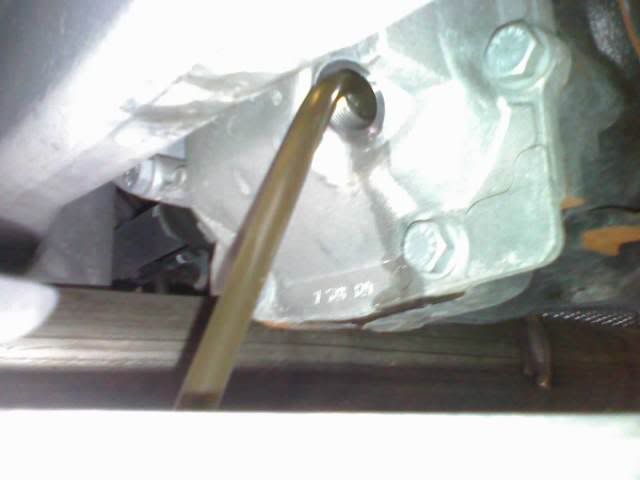

The plug is on the rear of the differential. It's a 14mm allen bolt. I used the allen socket to get it off. Sticking my finger in the fill hole, I could feel the oil level just below it's bottom. To get the oil out, I stuck in a plastic racking cane pilferred from my other hobby, homebrewing. You can use plastic surgical tubing, but the angle on the cane was perfect for hitting the bottom of the sump. Start to siphon the oil out, using whatever suction means you consider appropriate to start the flow. Here's what the old oil looked like coming out:
Yuck. It takes a little while for it to come out. If you have access to a suction pump, it will go faster. I didn't. Once drained, I took my cheap FNAPS suction pump and promptly discovered that the neck on a Red Line oil bottle is not "standard size". So, I scavanged an empty oil bottle off the drain rack and poured the gear oil into the empty bottle. Here's my set-up:
The differential took almost exactly one liter before oil started dribbling out the hole. I let it weep out, then reinsterted the plug and tightened until snug. All done!

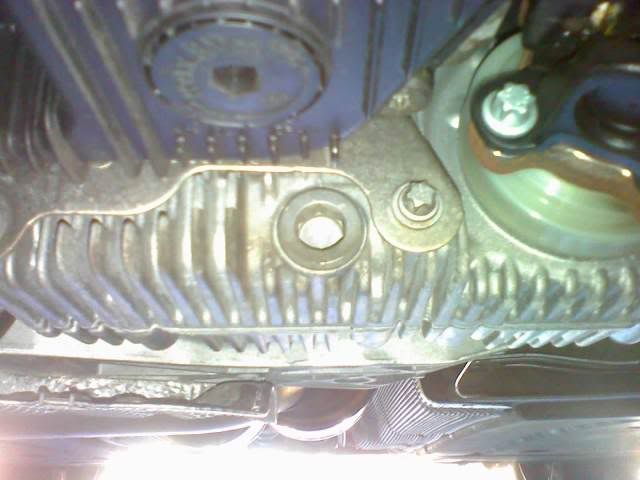

Now you're face to face with the front differential. Surprise, surprise! It has both a drain and fill hole! Apparently the engineers figure that if you go through all the effort of removing the cladding, you deserve a break. Warning- be careful not to confuse the oil sump drain and the differential drain! The oil drain is a hex bolt; the differential drain uses the same allen key you used in the rear. Remember, always loosen the fill plug before the drain plug! The drain plug is on the drivers side of the diff.
Once the drain plug was out, I removed the drain plug on the bottom of the diff:
After letting it drain, I re-insterted the plug and filled using the same pump as in the rear. The front took about 800ml of oil before overflowing.

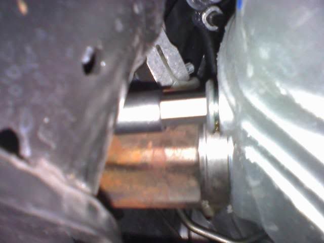

I'd intended to change the transfer case oil, too, but was scared off by the amount of interference blocking the fill hole:
Think I'll leave this one to the pros. The drain plug is easy, though:
