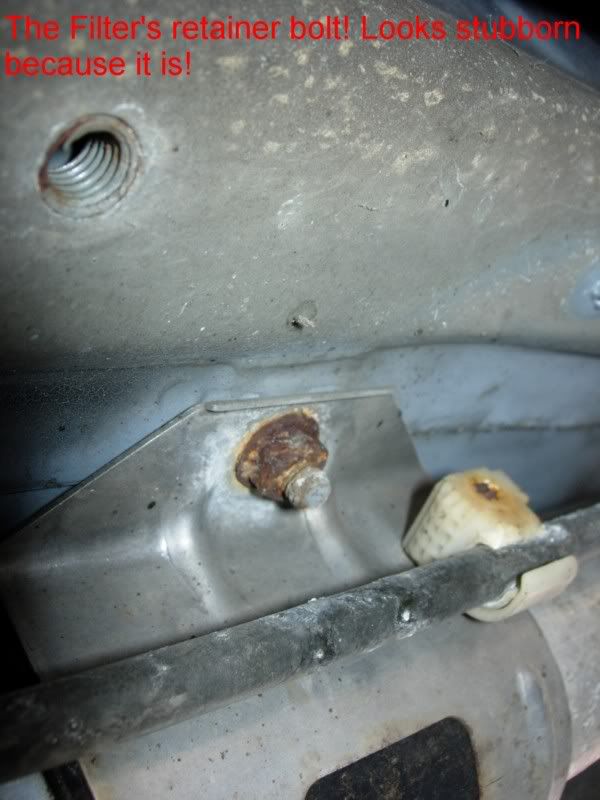

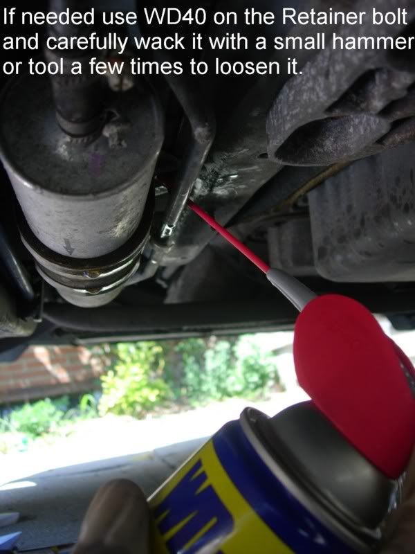

This is the Complete Pictorial Version of the Fuel Filter DIY for post 1994 E36. If you have a Pre 1994 E36 head over to the Pelican Parts DIY Section for your cars.
Because pictures are easier to read than words.
Sorry for the typos. I did this right after spending 2 hours under my car on a 100 degree day with gasoline all over me.
More following....

FYI: Took me about 2 hours to do this only because it was my first time and all three bolts were rusty and took effort to get off.
Normally this DIy would take about 40 minutes to an hour.
