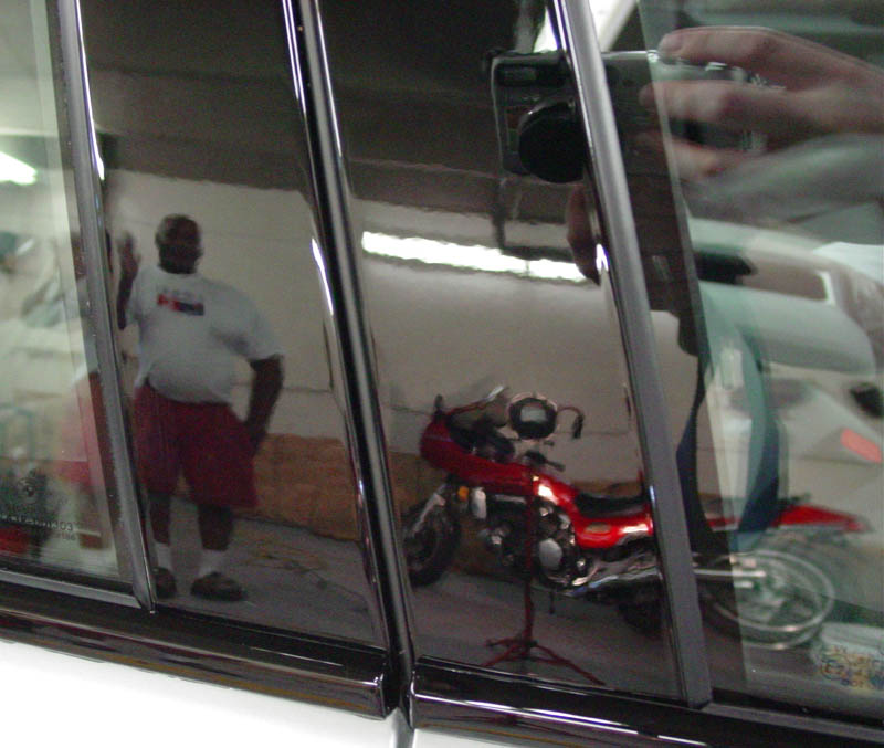

Kind of a cool pic ~90.8k
This is a section of the pic I posted in another thread about high gloss trim and dual paned windows.
The reason I posted this higher-res section of the original was that it shows a nifty thing about dual paned windows. You get dual reflections... More text below pic:
See how the window section of the pic looks like the camera may have been moving? Well, if you look in the high gloss trim part, you see that is not the case- it's clear (well, as clear textured trim allows). The glass part of the photo has a ghost shadow because of the second pane- which reflects the image again. Kinda nifty in a nerdy kinda way.

That is a GREAT picture of the high gloss Shadowline and double paned windows. Both are must have mods in my book. Very classy looking. The classy appearance of the windows is just a side benefit of the "vault" effect they provide, which is the main reason I decided to do the mod.

All windshields are double paned- on every car sold in the US. It's also how windshield repair works- You get a chip and the outside layer breaks, but the inside doesn't.
BMW does offer a climate control windshield for the 5 and 7's. I am pretty sure it has the inert gas that Tyrone speaks of between the panes.
The rear winshield glass is not double paned and BMW doesn't offer one for anything but protection models.
As for whether or not it helps insulate, I can say yes. The car is much cooler, and I experience less road noise with all but ~20% of the glass double paned.

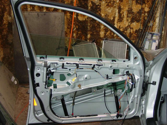

>>>would you know is the double pain avail for my new 330xi as a orderable part??? Is it just a direct glass replacement or require door guide heavy mods as well??
if' it's just replacing door glass i'd love to ''upgrade''!!
It's more than the door glass on an E39. You have to replace pretty much every piece of trim on the inside of the windows as well. Here is a pic from my install:
I am sure parts exist for teh E46, but I do not know what they are. Find bimmerfest member, Tyrone- The foremost Bimmer part and ETK wiz kid.
