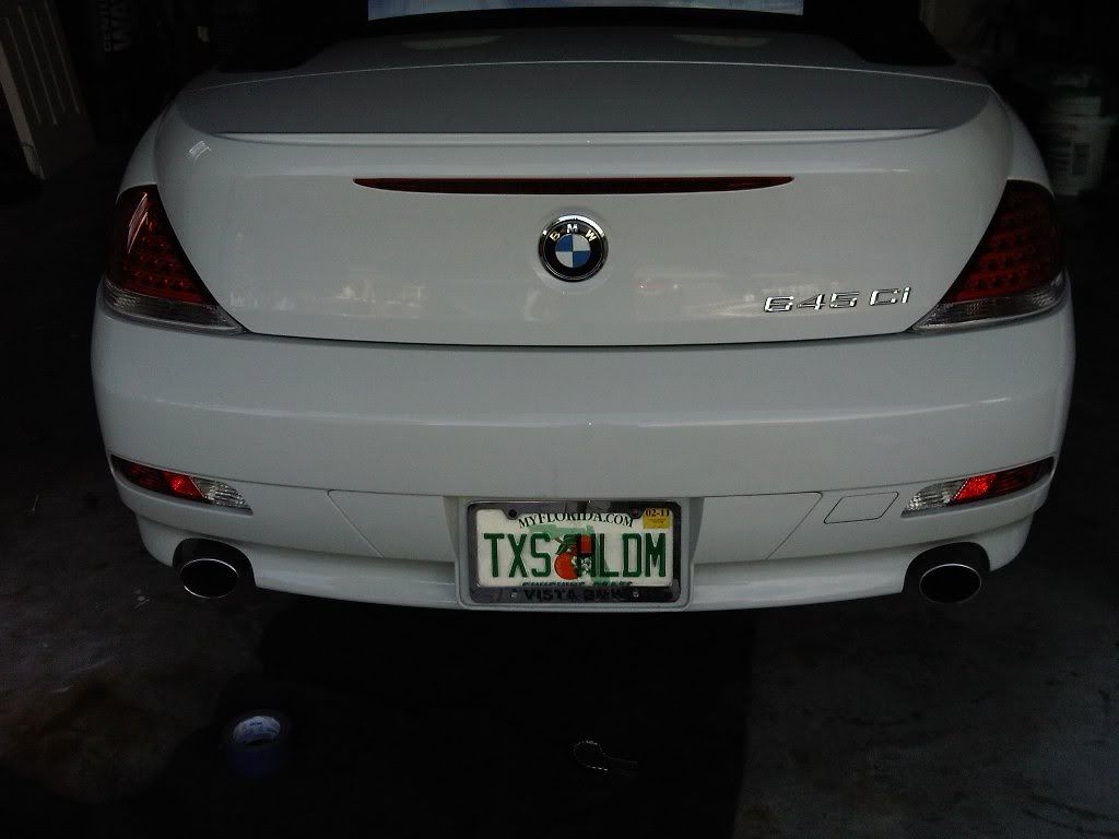

Here's the car before any work was done:

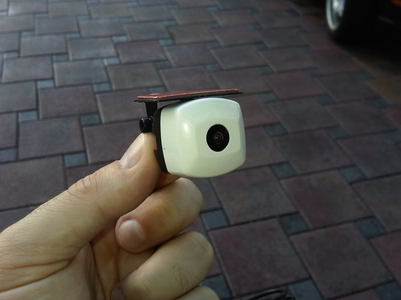

The camera with painted cover to match the car:

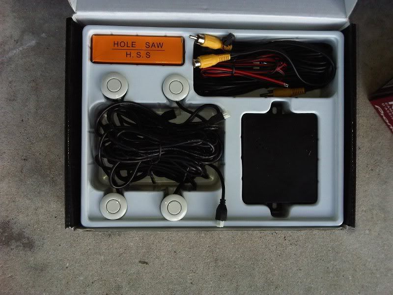

The Sensor Kit (with painted sensors):

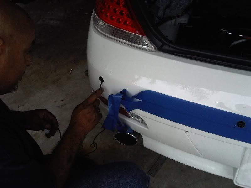

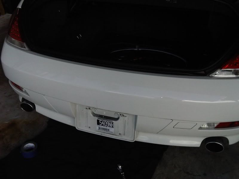

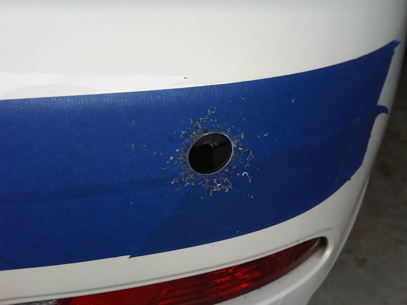

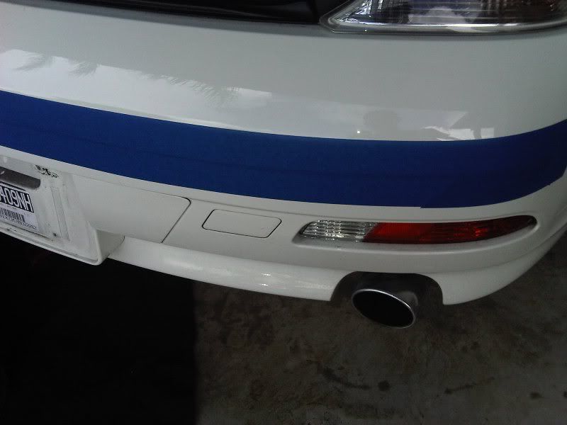

Next, the bumper was taped up to minimize any drilling damage.

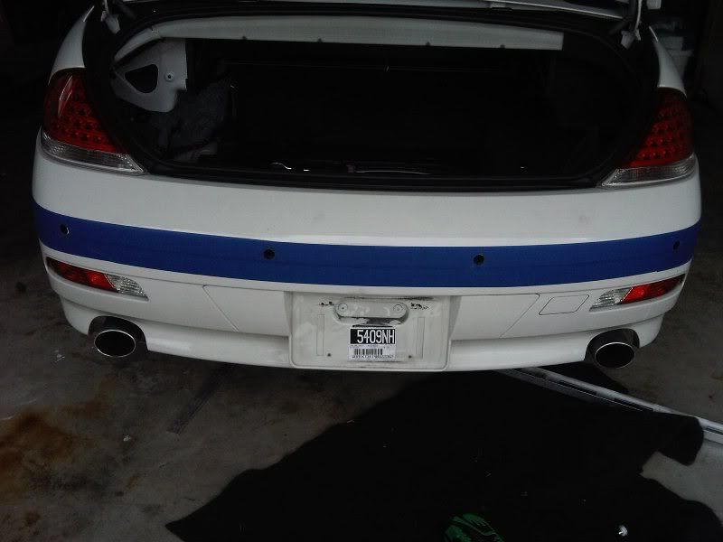

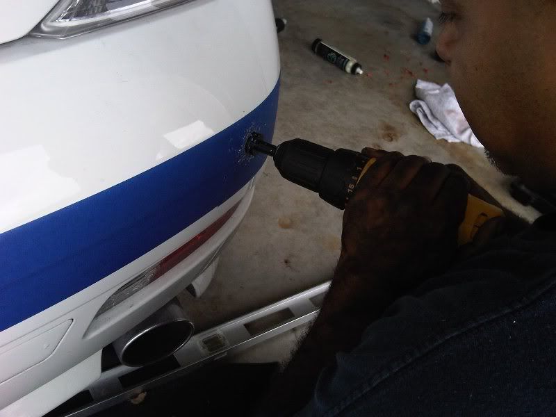

We measured about 4 times to ensure the placement of the sensors was both level and appropriately spaced across the bumper. I used pics of OEM sensor placement as guides and got it pretty close. Once we were both satisfied, drilling commenced:

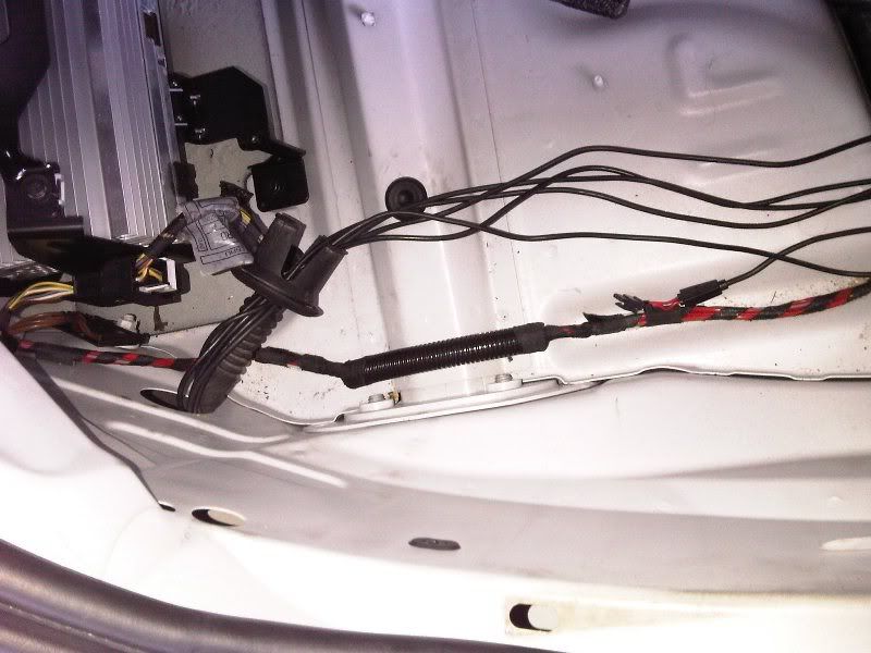

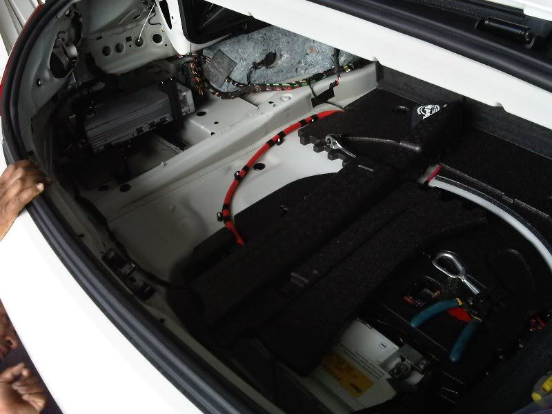

Next came the installation of the sensors. We had to find a way into the trunk and found it through an opening with a rubber stopper. The cables were pulled through using a fish tape.
(this pic is taken standing at the left side of the trunk looking down at the rear wall of the trunk closest to the bumper)

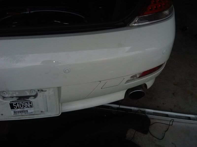

At this point, the sensors were all installed into the bumper (but still not working yet):

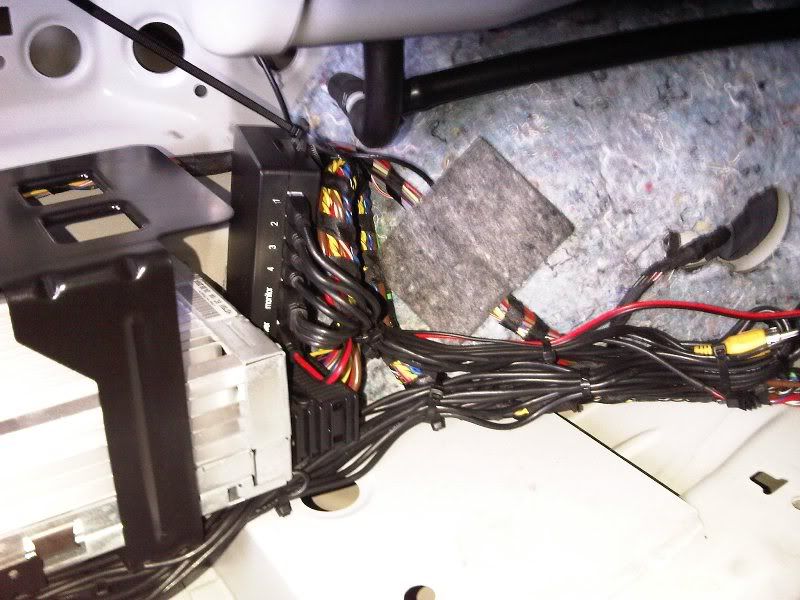

The sensor brain was tucked neatly away in a space that will be hidden by the driver's side trunk panel. Power was pulled from the reverse lights so the sensors (and, therefore, the beeping, are only engaged when in Reverse)

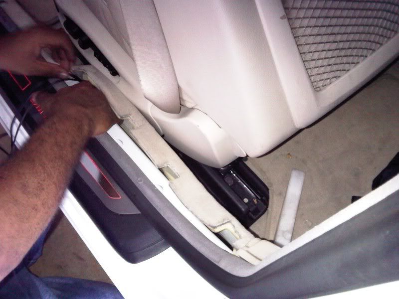

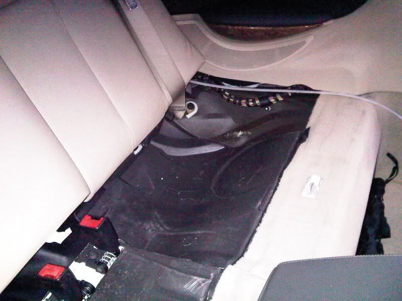

A hole for the camera was drilled behind the license plate (forgot to take pics) and the cable for it was fed into the car along with the sensor cables. The cables for the camera video and from the reverse sensor brain to its speaker were fed through to the front of the car where the speaker for the sensors and the camera brain would be installed. They were ran through an existing opening for cables on the driver's side under the rear seat. (You can see the long white plastic fish tape used to pull the wires through from the back. This pic is the rear seat with the cushion removed).
An accessory channel exists under the driver's side doorsill. The wires were run along that.

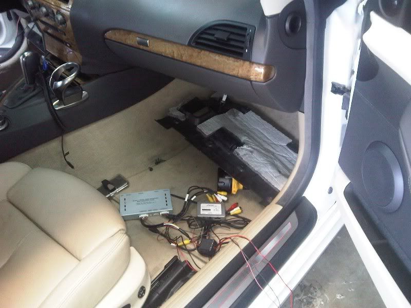

The reverse speaker was installed inside the panel just under the steering wheel. The remaining cables for the video camera and power pulled from the reverse lights were fed across to under the passenger side behind the glove box.

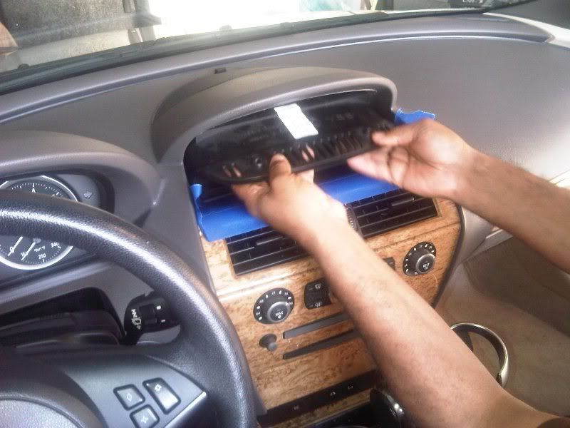

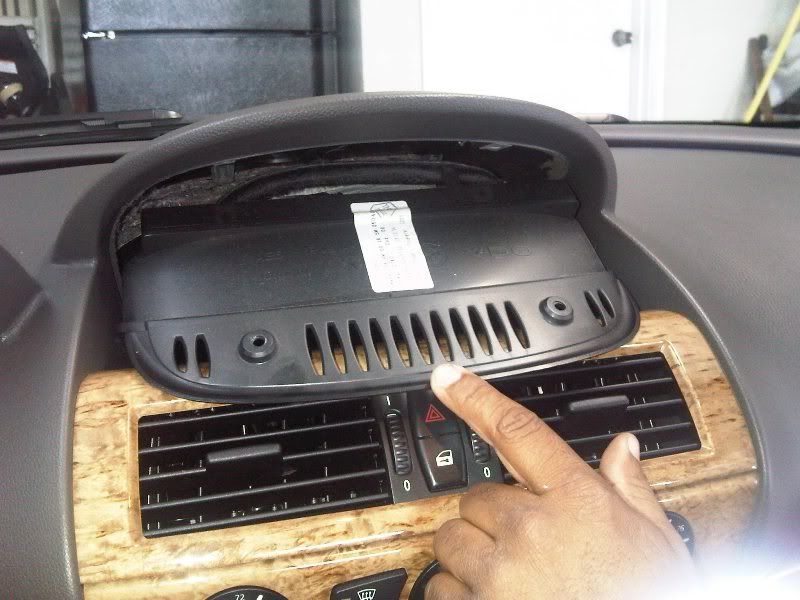

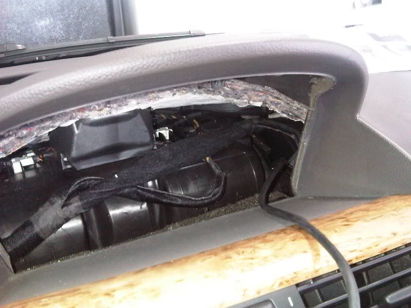

The iDrive screen was removed to include the interface for the video camera.
Frank, my installer, connected the camera, video interface, power and the iDrive screen (I told him I wanted to include a pic of him - he says everyone tells him "we always see your work but you're never in the pics..." so noone believes him <g>).

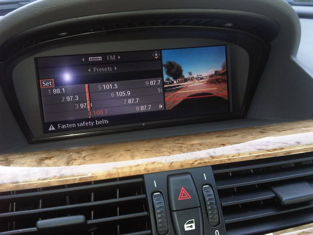

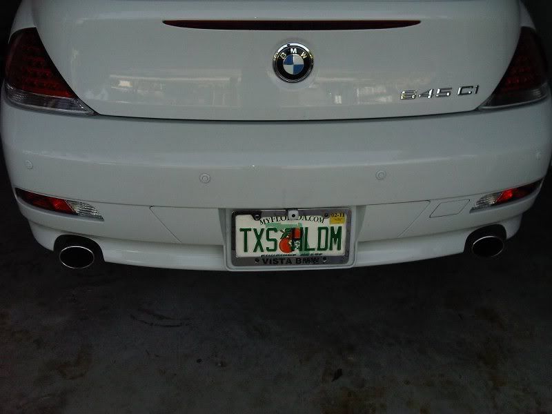

Here is a pic of the finished product (the camera is seen just above the license plate):
Here is a pic of the reverse camera in action. When engaged, it takes over the section of the screen that hosts the navigation. This particular camera has lines to show distance and alignment with a parking spot. It was very flexible to be configured my car.

Yes - only in reverse. The video goes back to normal (nav is there currently). The idea is the video input box interrupts the BMW video and superimposes the camera video onto the iDrive screen. When not engaged, it allows teh BMW video to flow to the screen as normal.
#18 ·
quick question, does the nav-video send video only to that small portion on the screen for backup, and full screen for DVD's or is it just displayed on that little section all the time?
#19 ·
According to Tony @ NavVideo, it displays over the navigation. So if you have the nav covering the entire screen, it should cover the entire screen. I was never able to change the nav to full screen (anyone know how???) and test. If someone can tell me how to set the nav to full screen, I'll test.
