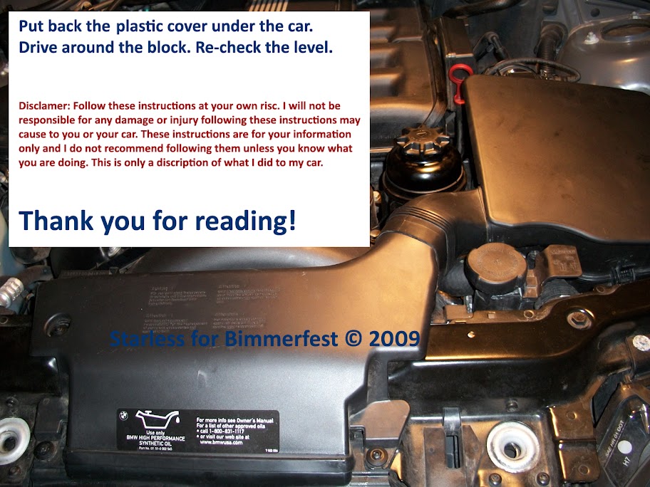

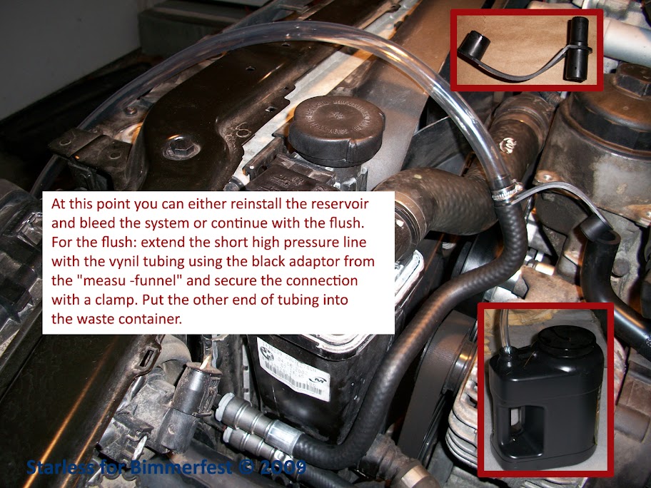

Hello, everybody. I was replacing my P/S lines yesterday and doing the complete system flush. I took pictures and made this picture guide. The reason for doing this was that some lines were leaking at a couple of spots and the P/S pump started making louder noise than it used to. After everything is completed, I'm enjoying the non-leaking P/S system and silently working pump.
I hope somebody finds this info helpful. All the text is in the pictures. Enjoy!

@Starless, thanks very much for this...I have found this to be the most comprehensive. I need to do this soon. Would it be better to follow this flush procedure first before replacing the hoses? Also, how fast does the fluid level go down? I might have to do this as a one man job and wondered if it was possible.
If you want/need to replace hoses, then definitely do the flush after since by doing this you will also bleed the system and there will be virtually no air pockets to worry about. If you want to do just the flush, the set up is going to be exactly the same. Just disconnect the lines from the reservoir.
The fluid goes down pretty fast. To give you an idea, that big funnel that I used will be almost empty in about 5 seconds after you start the engine. It will take about 10-15 seconds to go through that gallon of ATF that you will be adding into the funnel. That's why i did not use the reservoir for this purpose - it would empty out in one second and there is no way you would be able to add atf without letting the pump run dry.
You do need a helper to start and shut down the engine. It will take a coulpe of minutes of their time. Grab a relative, friend, neighbour or a passing by stranger. It's possible to do it by yourself but I'd not recommend it because the pump will run dry which is not a big deal for a couple of seconds, but then the system will be full of air and you'll have a hell of a time to bleed it. If you must do it by yourself, then I'd probable use the reservoir instead of the funnel and just dump atf into it to keep the flow. That would be tricky. Try to find somebody for 5 minutes!
