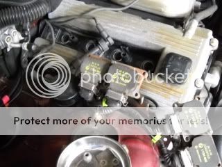

4804
Remove the coil packs nuts from the bracket on the wheel well and lay them out of the way.
4801
No need to totally remove the wiring to them, just lay them and the plug wires aside. You probably will have to unhook the round test plug and its ground wire to get it all to move.

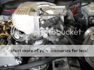

Begin to remove the hoses and electrical clips on the top of the intake. Watch out for the gaskets inside of each of the electrical clips. These small square rubber gaskets are there to keep out moisture and they fall out of the plugs. They all have them, they all fell out. Use masking tape and a marker to label where the hoses come from and goes to. This will save you a bunch of time when you reassemble it all. Label the electrical connection locations as well.

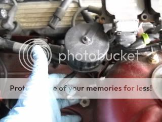

Do not remove the throttle cable from the throttle body, TB. There is a half moon shaped clip that holds a square metal fork like part from under the TB. Remove it, and disconnect and mark the 2 hoses that attach. Remove the bolts that hold the TB on. The bolt on the lower left can be removed only after the moon shaped clip is off. Remove the TB and lay the assembly near the brake master cylinder area. Don't bend the cables or stress the cables on it.
4812

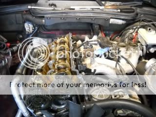

Remove the cam sensor from the front of the front timing case with an Allen wrench. Remove the thermostat housing, 4 bolts and it pops off. Remove the thermostat. Remove the front timing case cover, 6 bolts and it pops off.
Remove the chain tensioner from the right side of the block. You can disasemble it to clean it but it's not critical. You get it apart by striking it on a hard surface like a vise. It pops apart. Clean it out and put it back together in a vise by getting the spring clip in the collar and pressing it together in the vise. Use a rag in the vice jaws to protect it. Compress it to just under 68mm. You will hear the clip snap in place. Release the vise and it should measure 68.5mm. If its longer then that recompress it. It will get there.

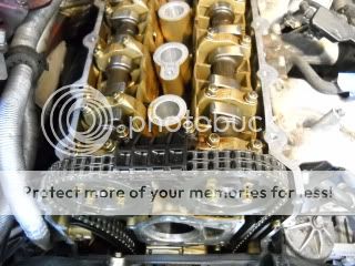

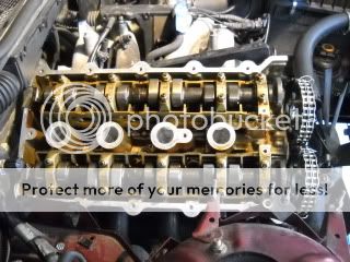

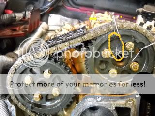

If you look at the front of the cam chain gears you will see a small arrow cast onto the front. These should both be pointing up, relative to the head surface, when you get TDC. (The engine is tilted at an angle to the right, so the arrows on the cam gears will look like they are pointing to the right as well when they are both "up".)
4814
This is the factory timing of the cams. Take a prick punch, (pointy punch), and make a mark on the front of the cam shaft where it comes through the sprocket, and another on the cam gear. I marked mine in line with the arrow that is already on the cam gears. (See the pic below.)
4817
I next wired my cam chain to the cam gears to keep the relationship of gears to chain and it also helps keep the chain from falling.

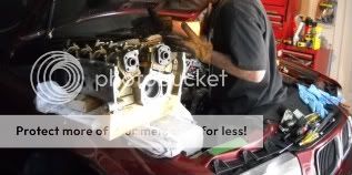

When it pops off it weighs around 60 lbs. I lifted mine off but help would make this much easier. (Don't drop it, it will break something expensive. New heads without cam's are $500. Cam's are $500. Toes are $500.) I placed mine on a couple of wooden 2x4's on the floor.

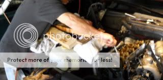

4839

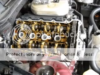

Here is a pic of the top of my engine. (My wife looked at it and said they looked like cup holders.)
4841

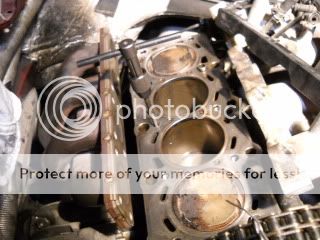

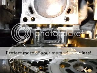

Here is the blown profile gasket that caused me to do this job. BMW was forced to repair many M42's under warranty because of this. Most of them blow between 50,000 and 75,000 miles. BMW will not cover this after warranty but will help a little with the parts cost if they do the repair. (Saving $200 on a $2,200 repair seems less then satisfying.)
4842
4843

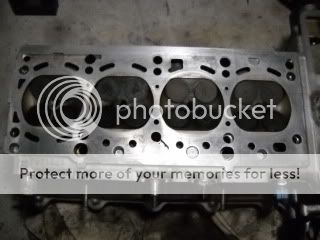

I spent the next hour with an abrasive plastic pot scrubber, the green pads you use in the kitchen, polishing the head and piston tops. I dried out all of the cylinders with a clean rag and used a screwdriver wrapped in a rag to clean out the head bolt threaded holes. These must be cleaned and empty before you put the new bolts in. I had the proper metric tap so I chased the threads after I cleaned them out, then I cleaned them again. Be careful not to loose the oil pressure check valve that in a hole in the block. It is under a rubber gasket. Leave it be if it is in there and make sure you don't loose it if it comes off with the head. It goes in one way and if you turn it around, or forget to replace it, your oil pressure will never be right again.
4845
I then used the same green pad to clean up the head. Be careful around the valves. Some will be raised out of their seats and can be easily bent. Do not let anything impact the valve faces.
You should check you heads for cracks and warpage with the straight edge. Read this about cracked heads. http://www.pelicanparts.com/BMW/tec...harticles/101-Projects-10-Machine-Shop-101/101-Projects-10-Machine-Shop-101.htm
4846

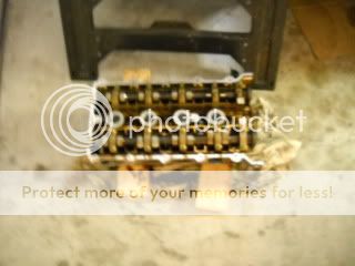

-look at the head and check the cam lobes. If the cam's moved while you were cleaning the head, turn them so that the number 1 cylinder lobes point to each other and the square ends of the cam's at the back of the head are square to each other with the reference holes up. They should look like the below pic. (This is not too critical because you have lowered the pistons.)
4820
I placed rag and a couple of 2x4's on my fender and set the head there as I climbed in to the engine compartment. I'm 5'6 and 150 and there was allot of room, even with the radiator in there. A 6 footer should fit. Used a step ladder in front of the car and placed a foot on the sway bar as I got in. Very easy to do and really saves the strain on the back. My wife thought I could do a Fred Flintstone car. (Sometimes she's funny, sometimes not so much.)
4882-cropped
Pull the cam gears and chain as forward as they will go. Then lower the head gently onto the block making sure the alignment nipples go easily into their holes. Check all around the head to make sure its flat on the block. It should not rock or move once it's down. Check the cam lobes and cam squares to make sure you have cams close to TDC.

The cam timing is not tough at all. I forgot to take a pic of the cam timing so here is allot of explanation. Your pistons were lowered in the cylinders. Now make sure the cam is still at TDC. The lobes on 1 are pointing towards each other. Place a straight edge on the rear metal cam squares and make sure they are straight to each other. (A second way is to place a small straight edge or bar against the virticle edge of one of the squares, the machined edge, and then place your machinist or try square on the head machined gasket surface to make sure the bar is square to the head.)
Now gently turn the crank bolt, clockwise about 45 degrees, to bring around the timing mark to the arrow on engine to get TDC on the crank. (Do not force it, if it binds it may be hitting a valve head.) Watch out that the cam chain and gears don't bind while turning the crank. Slide the cam chain gears on and finger tighten the bolts. The punch marks you made should be close if not perfect. You can wiggle the crank a little or use an adjustable wrench to wiggle the cams and get your marks in alignment, (the cam gear arrows should be pointing up as well). DO NOT TURN THE CAMS WITH THE WRENCH. It can bend the valves if they open into a piston. When you like the alignment torque the cam gear bolts to 10 Nm or 89 inch-lbs. (INCH POUNDS NOT FOOT POUNDS.) After they are tight, GENTLY turn the engine clockwise couple of turns to make sure no valves hit and everything moves smoothly. Replace the chain tensioner on the right side of the engine and turn the engine again.

Put on the throttle body spacer and both gaskets. Replace the throttle body and add the bolts.
Replace the square fork thing and the bracket with 2 bolts that holds it on. (Its function in life is to help warm up the throttle body with warm water from the engine. You probably didn't care, but there you go.) Make all of the water, vacuum, and remaining electrical connections.
4814
4817

4839
4842
4843
4845
4846
I removed all of the paper gasket pieces from all of the other machined surfaces; timing case, thermostat housing, and head, and polished them with the green pad. I cleaned out the timing chain profile gasket valleys with a round drift punch that fit the profile nicely. I cleaned out all of the baked on minerals and polished it with the green pad.
You are now ready to reassemble everything, starting with the head.
4820
4882-cropped
Replace the adjusting nut in the left chain rail and adjust it until it just hits the head, add the Allen bolt to lock it down. Replace the upper plastic chain rail with 2 Allen bolts.
