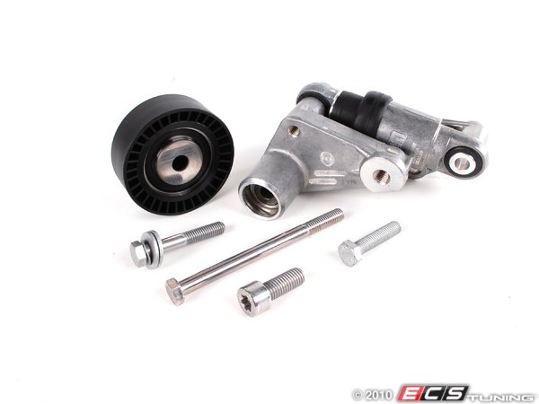

Wow. This is a little like a spy looking at grainy pictures of satellite photos; you have to know exactly what to look for.
With a mirror and flashlight, at high noon, looking down on the engine, I was able to see the two upper pulleys (or rollers or whatever they are), both of which had the ribbed serpentine belt on them backward (i.e., ribs outward) and one of which had an off-center bolt on its face.
Buried in between the belt going in and out of those two pulleys, I noticed in the mirror a dime-sized raised outside hex casting with a hole in the center.
Am I correct in these two assumptions:
ASSUMPTION: The pulley with the off-center bolt is the idler pulley?
ASSUMPTION: The raised dime-sized hollow hex casting indicates a mechanical tensioner?

Taking your advice to get a mechanic's mirror, looking down from the top at high noon with a flashlight, today I determined I have a mechanical upper tensioner (now that I know what to look for) on my serpentine belt.
ID:	233705   Click image for larger version

Removing the 9 strange philips head screws to lower the engine bottom plate, it was really easy to see that the A/C belt tensioner was also mechanical.
ID:	233707   Click image for larger version

Summary of this thread:
I. There is no way to tell other than looking whether you have mechanical or hydraulic tensioners (or both).
II. Personally, I'd replace hydraulic with hydraulic; mechanical with mechanical (both work just fine).
III. The so-called hydraulic isn't hydraulic anyway - it's a spring encased in oil (according to cn90 I think).
IV. For my mechanical tensioners, the pulley is a T50 Torx (but it's never needed since the pulleys are not sold separately for mechanical tensioners).
V. To adjust the mechanical tensioner, use a 16mm socket on the raised molded nut on the body.
VI. To remove the mechanical tensioner, use a 13mm socket to remove the two bolts on the sides.
VII. The pulleys are sold separately with the hydraulic tensioners (which are more complex than mechanical).
VIII. You need a 5mm or 3/16" allen wrench to hold the AC mechanical tensioner in place to remove & replace.

I just realized, from this thread today, WHY everyone said to twist the centerbolt of my (mechanical) tensioners ... while I just could not fathom exactly what that would have gained me.
Now I know ...
Apparently ...
FOR MECHANICAL TENSIONERS:
- There is never a need to turn the T50 Torx centerbolt ... because ...
a) The pulley isn't sold separately ... and ...
b) That's not how you release tension on the belts
(You use the 16mm boss molded into the body to release tension.)
However ...
FOR HYDRAULIC TENSIONERS:
- Apparently you DO need to turn the centerbolt ... because ...
a) The pulley is not sold with the tensioner ... and ...
b) Apparently that's how you release the belt tension.

Bluebee: There is one more option (since you like to be complete ). With some of the aftermarket mechanical tensioners like the one I got from NAPA you have to wrench on the bolt in the center of the pulley.
Original thread here: http://www.bimmerfest.com/forums/sho...038&highlight=
Oh my! Yes indeed. I will update the list of parts to indicate the warning about non-OEM tensioners. Your picture shows the problem quite clearly (I wish everyone posted a picture with their answers).
Again, in that thread you referenced, I see cn90 saying that turning the centerbolt (in the middle of the pulley) on both mechanical and hydraulic tensioners releases tension on the belt; but I can't for the life of me, fathom why you'd do that with the OEM (INA brand) mechanical tensioners.
