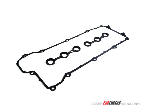

One of the easiest DIYs on our cars. We have replacement gasket sets below...
Click HERE for more information.
