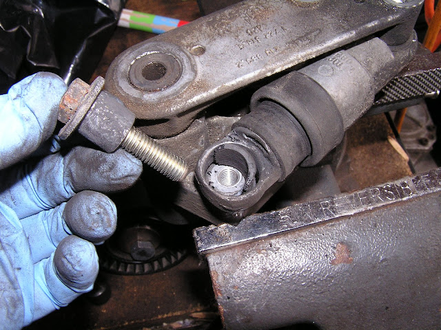

AC belt/tensioner/assembly....
Okay, I have looked at many diagrams and actual photos of what this whole area should look like when all put together correctly. However, I can't figure out which parts I am still missing. Here are a couple terribly blurry pictures I took from underneath the car.
I know this falls under the category of "horrible post", but I'm not really sure where I need to go from here. Also, where the belt goes on at the compressor, there is some rust and a piece that just sort of hangs there, I assume this isn't supposed to be like that, but like I said, not exactly my area of expertise. Any help or suggestions would be greatly appreciated.

I think you're missing an entire pulley, and that shock absorber-looking thing is a tensioner, but I can't tell where the loose end of it should be attached.

Crystal, it looks like you're missing an entire plate that pivots on that plastic covered stud! Your plastic tensioner pulley would bolt to that pate, and the tensioner spring/shock absorber-looking thingy bolts to the plate below the pulley. The plate with the pulley pivots upward, being pushed by the tensioner, and puts pressure on the belt.

I noticed the posted diagram has what appears to be a hydraulic tensioner on the bottom (compressor) belt and I'm not sure (from the diagram) if the upper tensioner is hydraulic (but I have the same picture on the E39 Bentley).
The blurry pictures provided are clearly of a hydraulic tensioner (which, incidentally, cn90 has found out, isn't really hydraulic either ... but that's an aside).

Yup. That's the same parts I had circled as an assembly in the Bentley Manual screen capture.
I'd just about bet you your A/C compressor is kaput. That would explain why someone stripped the tensioner pieces off the mount.

All the conversion write-up seem to be going FROM a mechanical TO a hydraulic tensioner. Crystal already has part of her original hydraulic tensioner setup. All she needs are the parts she noted in her last posting to put it back together as it was from the factory. She most likely can source those pieces from the pick-and-pull for very little.
Thanks for all the work writing, copying and pasting, bluebee!

I'm pretty sure Ken's right, most of the parts on my car are original.... lol which would be good I suppose if they were all there. It's a 92 (Oct 91) 325i, 6 cylinder. The tensioner is in the same condition as the rest of the engine. I was supposed to be moving before the deathly hot summer hit, so was just trying to be a good PO to whoever would be buying it. However, with a change of plans from the military, it looks like I'll be here, so I want to get the AC working before then. However on closer inspection, (and from the hindsight I've gained in other areas of the car) PO probably broke/removed these parts because they were:
a. making an abnormal noise
b. not working
c. damaged in the crash (front passenger fender was hit)
Thanks for all the info, I'll update (or post a new thread) when I decide to tackle it. Main issue right now is figuring out the MAF issue I have, which isn't something I'm enjoying either.

BTW, for reference, we finally figured out "why" a hydraulic tensioner "might" be better than a mechanical tensioner:
- WHY would a hydraulic belt tensioner be any quieter than a mechanical belt tensioner?
