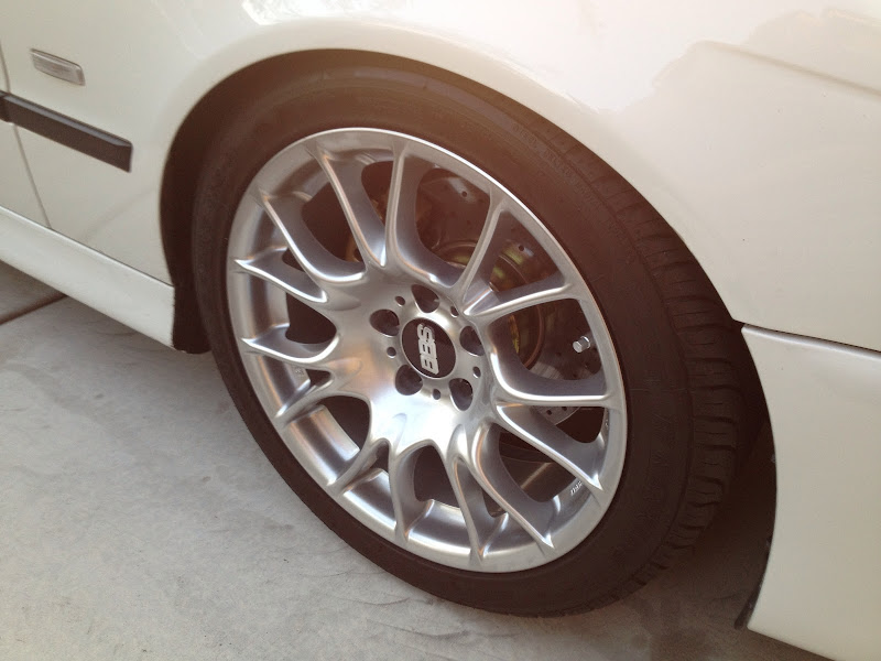

Got my 15mm spacers in the mail today. They are aluminum with a 74.1mm hub centric bore. Also bought some extended wheel bolts. Stock is 28mm and the extended is 15mm longer at 43mm.
Wheel bolts:
Front before spacer:
Rear before spacer:
Spacers:
Front after spacer:
Rear after spacer:
Completed:

Spacers I bought from a seller on ebay ....I've bought spacer from him in the past so I felt comfortable doing business with him. A set of four 15mm spacers cost $96.00.
Here's a link :
http://motors.shop.ebay.com/lugs-n-s...911.m270.l1313
Wheel bolts were bought from another Ebay seller. A set of twenty 10.9 Grade bolts cost $35.00:
Linky:
http://www.ebay.com/itm/Lug-Bolts-Co...sories&vxp=mtr

Keep in mind ....always measure the gap between the inner fender lip and the outer edge of your tire to determine how thick a spacer you can fit. I had about 16mm of space in the rear and and 17mm in the front. The 15mm spacers have brought me very close to inner lip of the fender. In fact I did notice two instances of fender rub in the rear. This should resolve itself once I install the appropriate tire size on the rear. I am currently running a 265/35/18 on the rear, but it should be a 245/35/18 on an 18x8" wheel.
