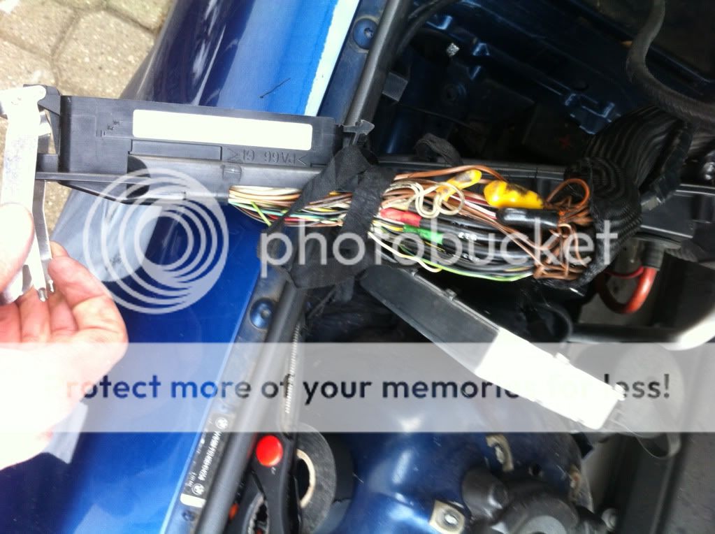

Ok I snipped the EWS green 66 wire going to the ECU. Now I'm looking for the EWS module under the dash(I have an e34). I'm having a hard time distinguishing it from all the other crap under there. I'm consulting the bentley wiring diagrams but they are a little harder for me to find. I'm used to my '81 528's diagrams. Little more simple haha.
So Any tip on how to find it on an e34? Is the harness always yellow?
I have not done it on the E34, but the connector for the EWS module on my E36 was yellow.
You may want to PM Supertech777. He did it on his E34.

I've found the EWS box up under my dash and the e36 wire colors aren't the same in the e34. Annnnd I've been banging my head against a wall with my bentley manual. I'm looking at the wiring diagrams for the coded drive away protection and THOSE color wires don't match at all. Not even close. Then I realize the diagram I'm looking at is for "1993 535i, 1993 & 1995 525i & 525i touring." So why would the diagram be the same for a 93 535i that had EWS1??? I'm guessing the bentley manual doesn't cover late model 95 cars with the EWSII. Kinda weird. I was expecting a little more for the bentley but oh well. I found a wiring diagram online that seems to fit my colored wiring. Also trying to collaborate with Supertech777 because he has a e34 as well with a EWS delete. I'll keep posting progress.
