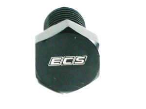

Magnetic Oil Drain Plug. Yea or Nay?
I am prepping for my 530i oil change. I've ordered Rhino Ramps, drain pan, 36 mm ratchet, Mann oil filter, and will purchase BMW oil locally (unless you know a cheaper place to order BMW oil). I already have a 17 mm ratchet.
Should I replace the existing drain plug with a magnetic drain plug (cost = $3.49 - $29.95).
http://www.amazon.com/BMW-Magnetic-O...XY/ref=lh_ni_t Amazon (assume this is a weaker magnet)
http://www.drainplugmagnets.com/bmw.php Most Recommended/expensive
My assumption is magnetic drain plugs are suppose to trap and hold metal shavings that may become present in the oil over time.
(OR is it a snake-oil product?)
Should I install the magnetic drain plug? Yes or No and why?

First, the Rhino ramps might be a waste of $$. I have them, could not use them for my e39 when I had the non-sport suspension, and especially now with lowered setting not even close. If you have an SUV (which I also have), they will serve you well.
Concerning the magnetic plug, you do whatever you want.
A "regular" plug will not trap iron shavings, but if the thread goes bust, I'm not losing the oil pan - the OEM plug is designed to be hollow for cases like overtorquing. The bolt will shear off without stripping the threads of the oil pan. Also if you "gravity" drain the oil, all shavings go down the drain anyways. You can spot them in the catching pan when you fill the oil bottles for recycling. That's what I do.

[SIZE=2]Concerning the magnetic plug, you do whatever you want.
Good call on the potential of stripping the oil pan. That would make a $3.49 gadget cost much more if not careful.
As for the shavings draining WITH the oil. I believe the issue is they are traveling throughout your engine UNTIL you drain the oil vs being trapped by the magnetic drain plug keeping some of the metal shavings away from the engine between oil changes.
Great input and thank you.

Get 2 or 3 flat, strong magnets and put them on the bottom of your oil pan. When it comes time to do an oil change remove the magnets, drain the oil then replace the magnets.
That's what ZF do on their trannies but their magnets are inside the pan.

The engine is primarily made of aluminum, except for the crank, rings, wrist pins, valves, timing chain and sprockets.
Probably not much of an issue, but, if you'll feel better, by all means, put one in.
BTW, BMW does not see fit to specify one for the engine, or manual trans. Can't remember if the diff has one.

So that should put it at rest. Magnets do not attract aluminum particles. I knew I had an oversight somewhere. Thanks Ed.
P.S. it should work in iron block - if one is compelled to use it. But then, I would do the oil pan magnets as suggested above (like the tranny pan magnets)

Magnetic drain plug makes sense for Trans and Rear Diff because these items have no filters (for most cars).
Engine Oil is being filtered all the time (down to ? 10 microns, not sure but look it up re exact micron).
So I'd not worry too much about magnetic engine drain plug.
