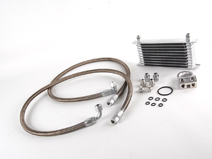

Can any of you m3 guys help out. I would like to add an oil cooler to my 328 track car. It the vanos bolt issue the only mod that is needed? I understand the an adapter if I want an lines.

There are several different ways to go after adding an oil cooler to the E36. HERE is a link to one of the methods. I find this to be one of the easiest ways to add on an oil cooler. As for the oil cooler it self, you have a few paths you could take, the Euro Oil Cooler from the E36 M3, the S54 Z3 oil cooler, or an after market unit such as one of the Mishimoto ones found HERE.
