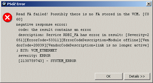

Unhappy Having issues reading Vehicle Info
I downloaded all the files and installed. Copied SWE files to correct locations. I opened the options and pointed to the EST file location.
I can connect okay but when I try to read vehicle info I get the following errors:
Close it and get this one:
When I try to read VCM I get this error:
Please help.

@Bigsarge
Make sure your car's Ignition is turned on. Otherwise you'll get all kinds of Ethernet errors.
Ignition was on but not started. I just hit the start button once without my foot on the brake. Also, I don't know where the PIN number comes into the procedure. I find it odd that a PIN is provided but I haven't run into where to input it.
Kevin

You have to hit twice and instrument cluster should be active during coding.

I got it to connect and read today. I disabled my wireless and reconnected to my X3. Everything worked after that but I'm not quite sure if disabling the wireless was the fix or just using "repair" to reconnect to the X3. No changes made to my F25 X3 but I will do more when I have time. I had a tough time trying to find what I wanted to change but I was in a hurry due to lack of time.
Thanks for all the suggestions.

I'm not the only one with this issue.... same build date as me, 05-2012. Check this link out:
http://www.bmwcoding.com/showthread....ewer-than-46.3

Seems like there is a 46.5 and 46.6 version out there. That might be the solution to my problem. Anyone have access to the newer data files? I can test it ASAP!
