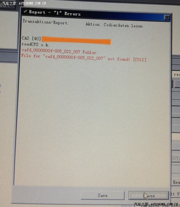

mistake at
First time full backup of Car's configuration files:
12.Right click on each green CAFD and click on "Read Coding data". Afre codes are read, green icon will change into a folder icon.
report -"1" Errors
Transaktions-Report: Aktion:Codierdaten lesen
CAS[40]
readCPS O.K
cafd_0000000f-005_022_007 Fehler:
File for "cafd_0000000f-005_022_007" not found***65281;[c012]
Pls tell me how can i do ?
Thanks.

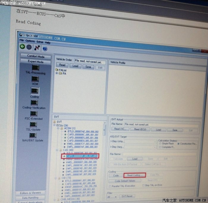

[IMG]http://www.autoimg*****album/userphotos/2012/9/9/500_7df3_bb4e670a_bb4e670a.jpg?7291[/IMG]
[br]
[IMG]http://www.autoimg*****album/userphotos/2012/9/9/500_4581_d751054e_d751054e.jpg?7806[/IMG]

Give us more info to understand your problem better. Your car model , psdz day used?
Are you able to read any other cafd file?
sorry, i am chinese. so don't good at english.
my car is 2012 F18 535Li
what is mean of "psdz day used" ?
i can't read any cafd file.
it said can not found files.

If you are able to read at least few cafd files, it's then just psdz data set issue. Change to 46.3 or to next higher version.

Please read the manual installation steps and see if you have followed correctly. Also have you assigned the key to E-Sys?
