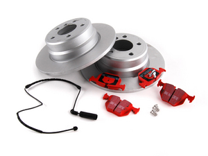

Alrighty, pads, rotors, and sensors are all different from to rear on the E53. To make things a little easier on you HERE is a link to my braking section for the E53 3.0, inside of this section we have RPS kits LINK (rotors, pads, and senors) which include very thing you need for a basic brake job. My most popular combination on the E52 is Brembo rotors with EBC RedStuff pads, this would be a performance upgrade from your stock brakes, but still be a quiet lower dusting alternative.
