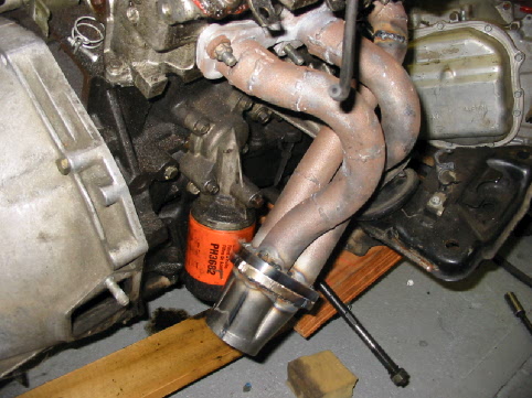

While the are not pretty, I have a bit of experience prototyping and using headers for a couple cars:
the non-turbo Z32 300zx. Which these headers basically did almost nothing to add power. In fact, having full-length headers (about 36" long) reduced torque in a few areas. The problem is, not being able to tune them and try several sets until you get the right length and size. These were then cut off, and I had some flanges made so I could try to add different ends to the headers to try to find the right combo. I never finished the job. It was a waste of time.
the GM 3400 DOHC motor transplanted in a lowly Pontiac Fiero. What a tight fit. and these were equal length, and full-length as well.
http://fiero*****fiero-tdc/members/mw...ers/index.html
[IMG]http://fiero*****fiero-tdc/members/mws/headers/Rbank1.jpg[/IMG]
these headers worked better because I also changed the intake radically and adjusted the cams. I achieved a 38% gain in power, which was really good for a NA motor.
http://fiero*****fiero-tdc/members/mws/intake/index.html
[IMG]http://fiero*****fiero-tdc/members/mws/intake/240hp.JPG[/IMG]
It would be difficult to be able to tune headers to know what to do with VANOS and Valvetronic.
That said, some sort of short, tubular manifold would be better than the log. So that "would" alleviate some restriction.
I think the only mufflers restricting anything are the "Center" and rear mufflers. The front mufflers are just perf-tube and replacing them with straight pipes would just add more ratty noise, from my experience.
