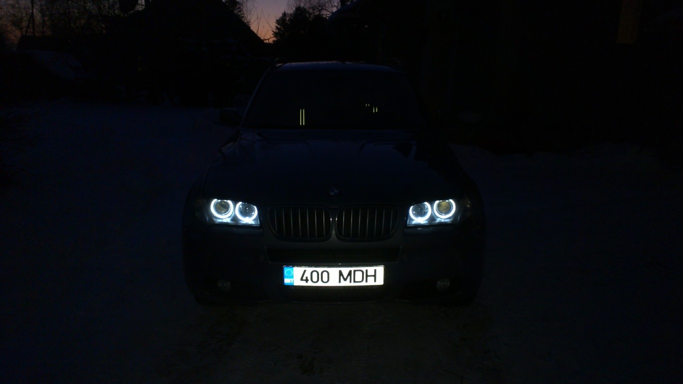

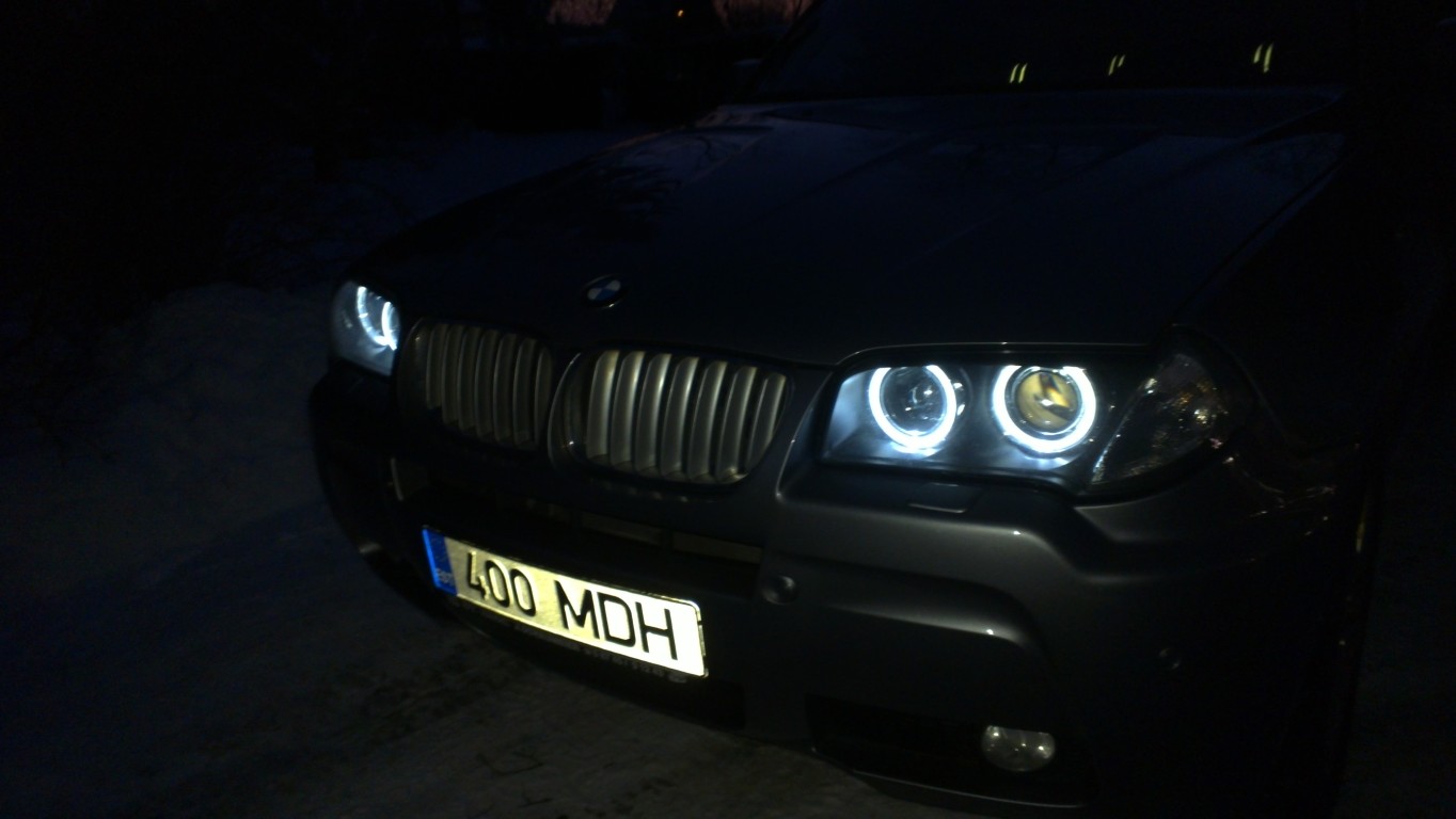

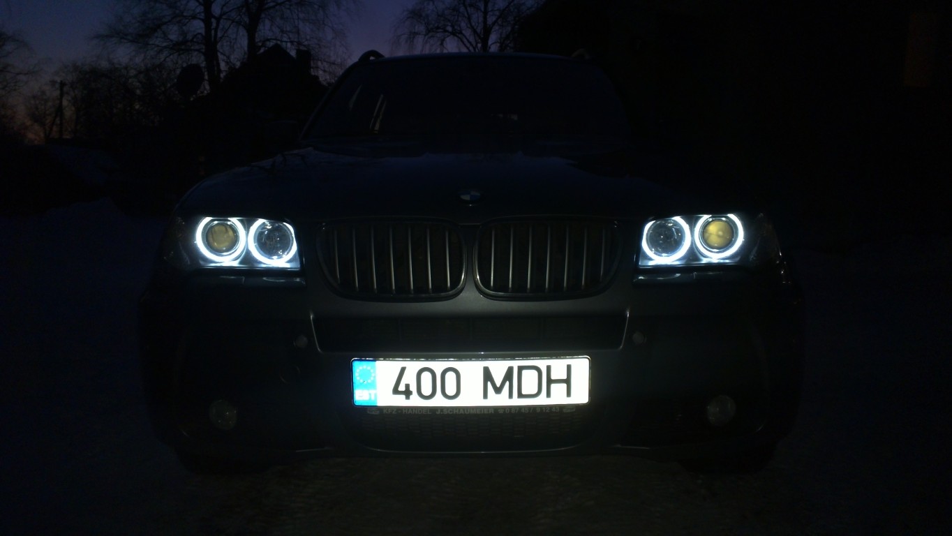

I am using brightest and most powerful 25w (2x12.5w) LEDs on the market:
Original vs. LED:
LED:
However, I am not happy as these LED's are still not bright enought to be used as daytime driving lights.
This is the set I bought: http://cgi.ebay.com/ws/eBayISAPI.dll...m=281072557919
Besides them not being bright enough, are you experiencing any other issues with them? any negative effect on the stock wiring ?

Mein Auto: BMW E83 X3 3.0sd, 210kw
No. I do not have any other issues with them. Installation was easy plug and play. No fault codes.
