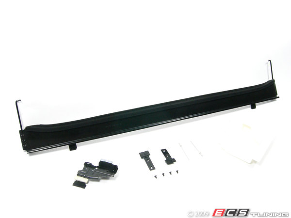

E46 Sunroof problems have been a known issue for a long time. So much so that BMW has created an OEM repair for this...
Click HERE to order or for more information.
