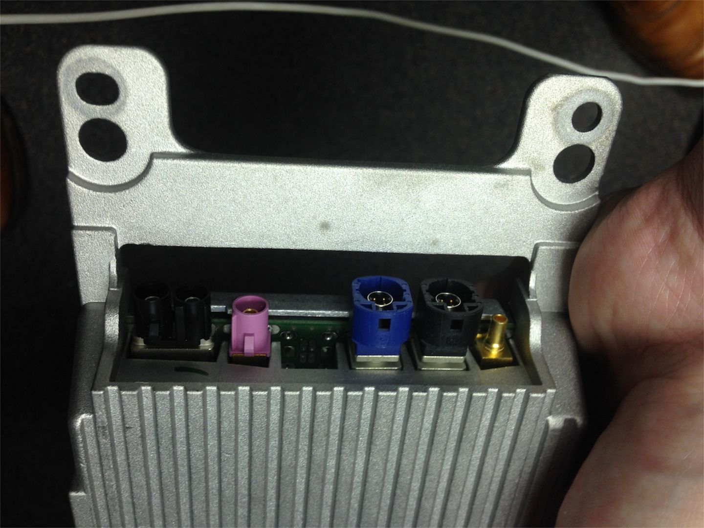

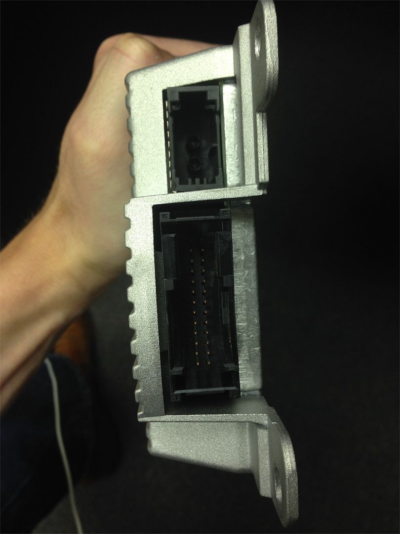

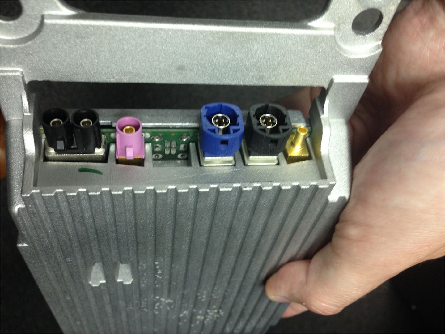

Originally Posted by schpenxel View Post
Pics from today below. I was bored and decided to take a look at the TCU and compare the connections to the combox. My last connector for the tcu/combox retrofit wiring harness will be here on Wednesday--I almost just went forward without it, but then decided to just wait
Which cables are required for the retrofit?

I will be posting a complete DIY with pictures and part numbers once I have everything together.

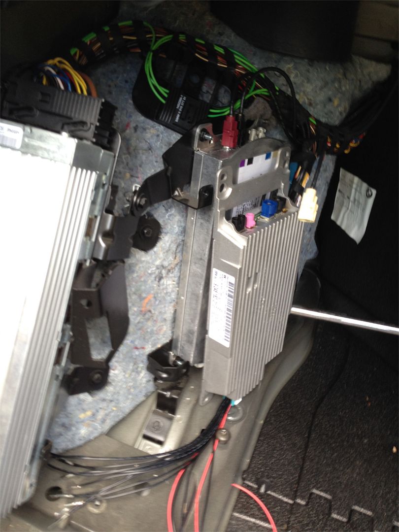

And the magic connectors came in today from Kufatec from the plug and play combox retrofit harness. Will finish the harnesses tonight

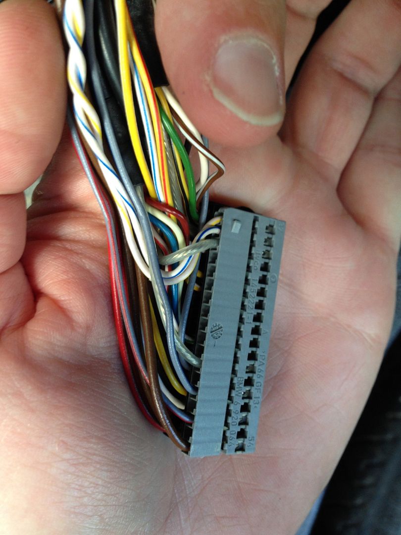

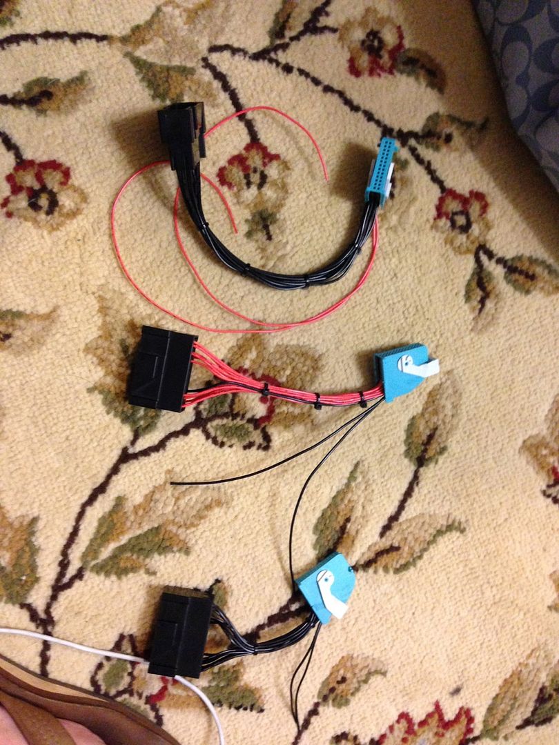

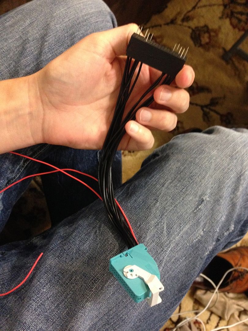

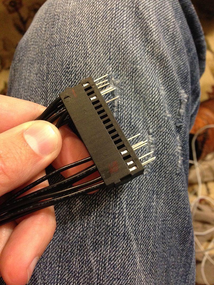

Harnesses are ready for testing.. I made three. The second one came out best I think--was running out of wire on the last one so had to make it short, lol. Detailed DIY coming in the next few days..

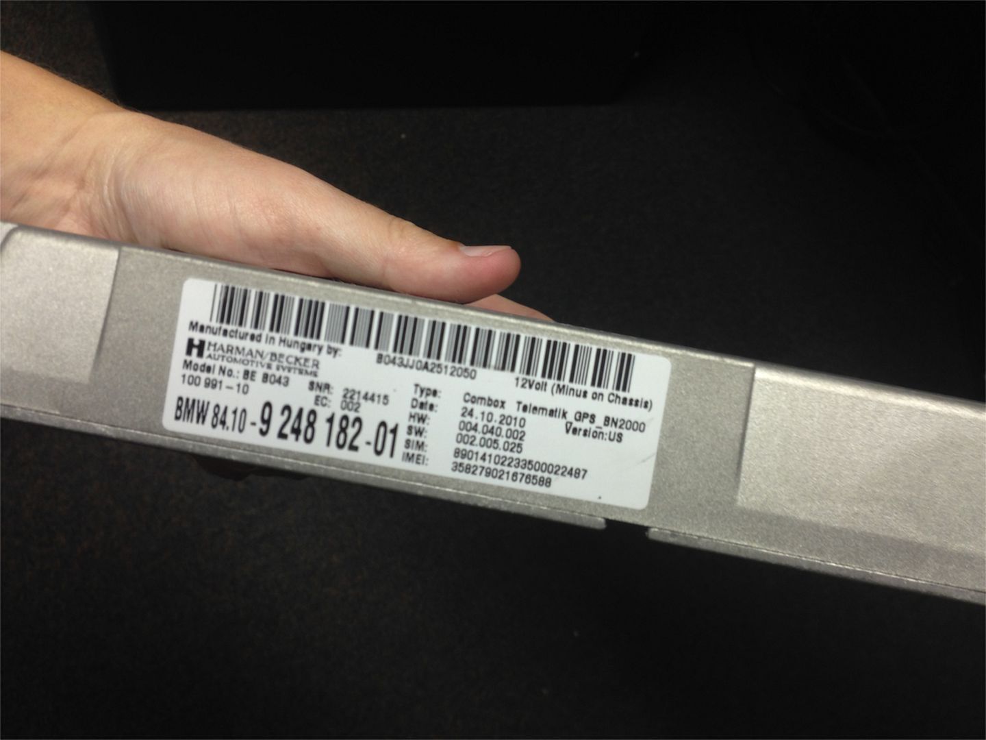

Someone PM'd me earlier and pointed out a possible problem.. the combox I bought is listed as
Code:
S609A=No
S639A=Yes
S6VCA=Yes
on realoem--so I am not sure it will work my setup. Still worth a shot though!
http://www.realoem.com/bmw/showparts...=84&fg=10&hl=1
