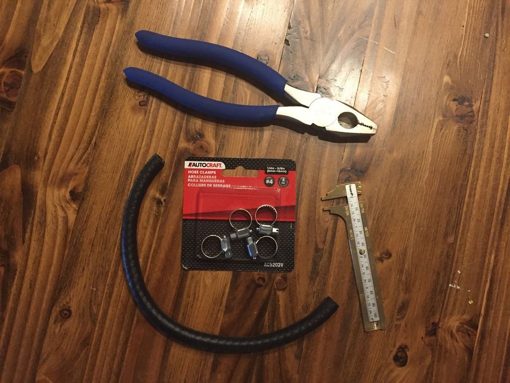

Supplies - 1ft of 1/4" ID fuel hose (OD doesn't really matter), some hose clamps, a pair of cut-off pliers, and a caliper (not required, just wanted to measure the plastic tube OD). Not shown here but also used - safety glasses (I don't like gasoline in my eyes), some rags to clean up fuel drips, and a flat-head screwdriver for the hose clamps.

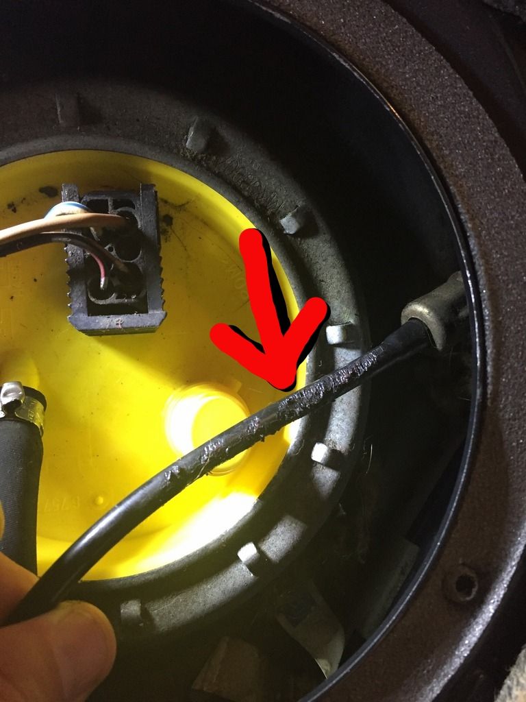

I had left everything exposed after replacing the fuel level sending unit, so if you're just starting this, you'll need to follow directions from Pelican Parts or wherever to expose the fuel pump area. You can see here that the plastic tube has some pretty good teeth marks on it from some adventurous little rodent. I've expertly drawn an arrow to show where the pinhole was that hopefully sprayed that little varmint in the face. For what it's worth, the plastic tubing measured out at roughly 6mm OD, which is about 1/4". pshovest, you were spot on.

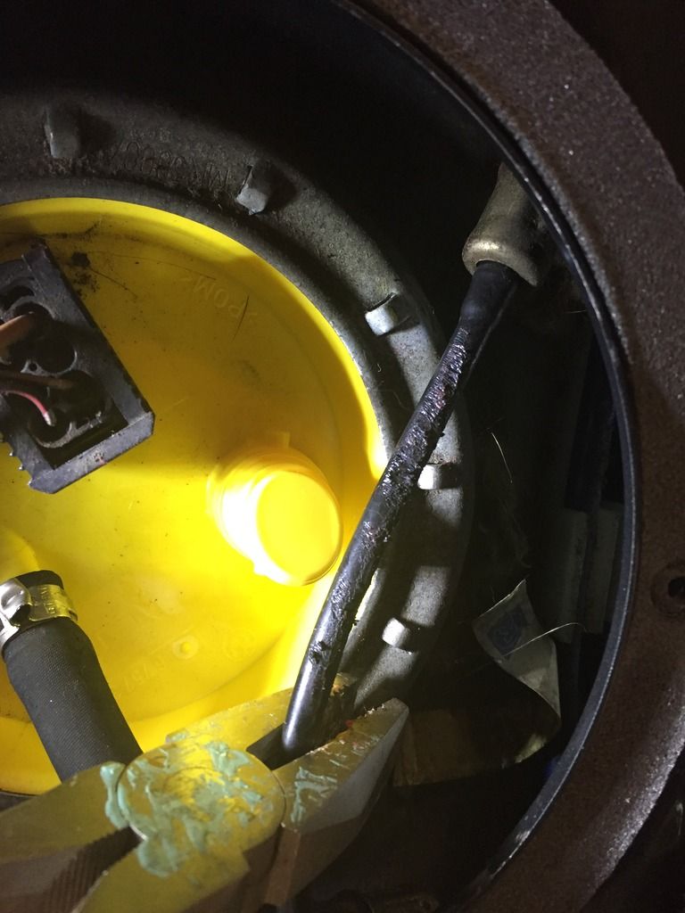

First step is to cut the plastic tube on one side of the damaged area. Pro tip here - make sure you hold on to the side that runs back to the fuel filler. I had both hands on the pliers and the fuel filler-side hose slid itself back into the cavity and was a little hard to find. If that does happen despite your best efforts, just reach your left hand in there and root around behind the blue hoses and you should be able to find it.

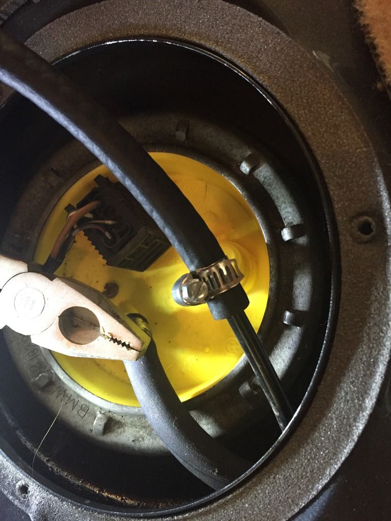

Now that you've got a clean surface on the fuel filler-side tube, you can slide the new 1/4" ID fuel hose over with the hose clamp ready to go and tighten it down enough that it doesn't fall off (but not completely tight just yet). You can see I haven't cut the new fuel hose to size yet - the longer length gives me something to hold on so I don't lose it down the hole and also lets me cut to the right length in the next step.

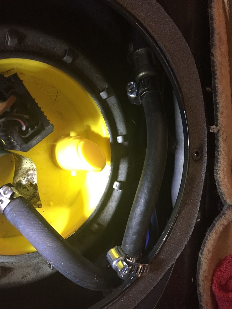

Anyways, I left about an inch of plastic tubing left, which I figured would be enough to slide the new hose piece over and provide surface area for clamping (not be confused with "glamping"). Once I had this in place and clamped, I tightened both clamps down to the precise measurement of "reasonably tight".
Now that it's all hooked up, I gave a couple light tugs on the new hose at either end to convince myself that it wasn't going anywhere, and then tucked it back in the fuel pump cavity, and reassembled the fuel pump covering.

Just a small update - I ran down to the gas station and topped it off to see what would happen. There was a tiny drip of fuel out of the fuel filler-side hose near the clamp, so I tightened it down. Other side seemed to hold well.
I'm going to tentatively consider this a success, especially for $3 in parts. It's miller time!
