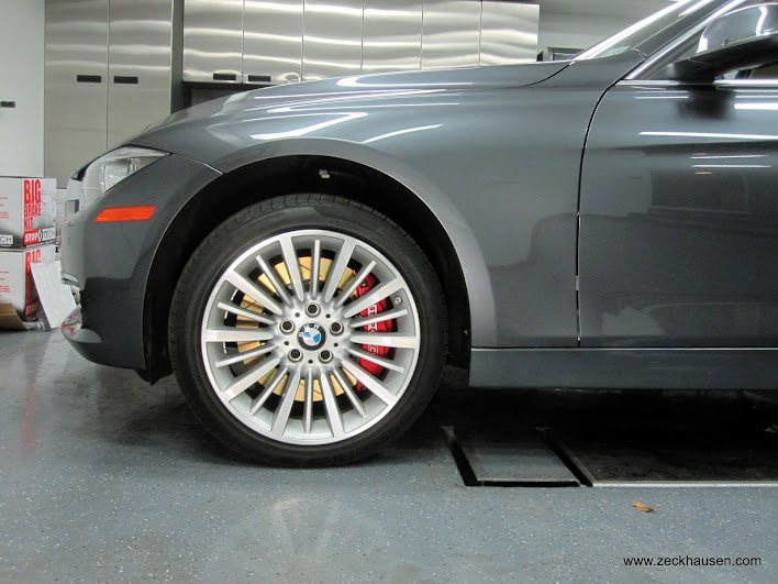

A few months ago, StopTech released a big brake upgrade for the F30 335i. This new kit is specific to the F30 328i, with slightly smaller caliper piston sizing for proper brake balance and a smaller diameter parking brake drum than the 335i kit. This is the world's first installation of the new 328i kit. (Well - it's the first permanent installation. Obviously the test car StopTech used had one installed briefly, but it's now back to stock.)
I had planned the 4-wheel upgrade on my 2012 BMW 328i Luxury Line this Saturday, with some friends coming over to "help" (meaning hang out and talk cars), followed by a parade over to Panevino Restaurant in Livingston, NJ for lunch. But the pressure of the incoming hurricane, plus the sexy StopTech boxes in my garage combined to make delay of gratification virtually impossible. So I installed the front kit last night. It was probably the easiest installation I've ever done.
The rear kit installation is still scheduled for tomorrow morning in Maplewood, so the "brake-fest" is still on!
If you're on Facebook, here's a link directly to the photo album, which gets you higher resolution shots, if you want: 328i Installation Album
Otherwise ...

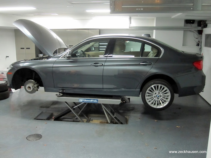

Lifting the car just high enough to get the front wheels off easily.

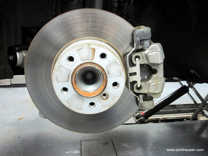

The puny stock front brakes. That's a single-piston floating caliper.
I'm really loving this new garage and the mid-rise lift. It makes tire changes and brake work so much easier and faster.
First step is to disconnect the stock brake line and snap a rubber cap over the end, to keep fluid from draining out. Then pull the pad wear sensor, remove the 6mm rotor retaining screw from the hub, and remove the two 18mm bolts holding the caliper in place.
The caliper and rotor are off. I've already bolted the StopTech caliper adapter bracket in place, using the stock BMW caliper mounting bolts. Torque to 81 lb-ft.
