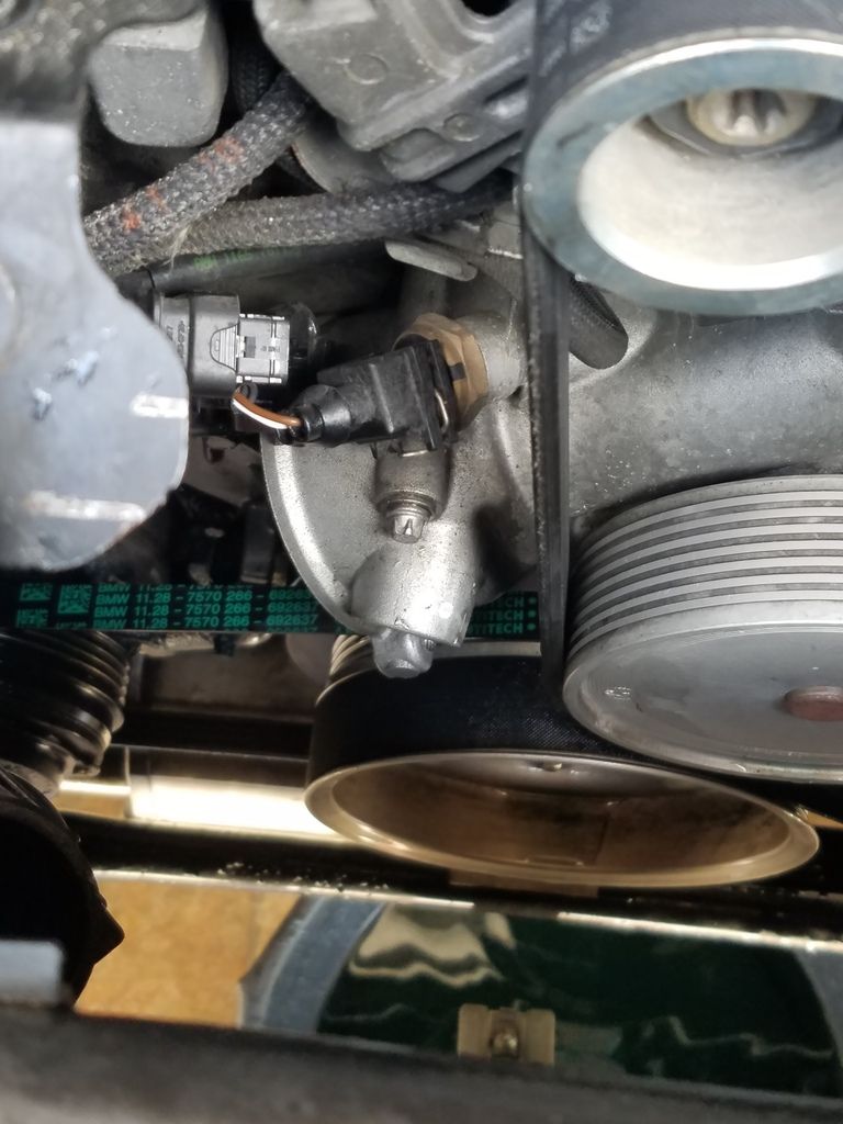

You will be able to see the thermostat from the bottom quite well, and access the difficult torx bolt holding the thermostat towards the block. But dont get excited, you'll want to remove the assembly from the top if you don't want to be douched with coolant lol.

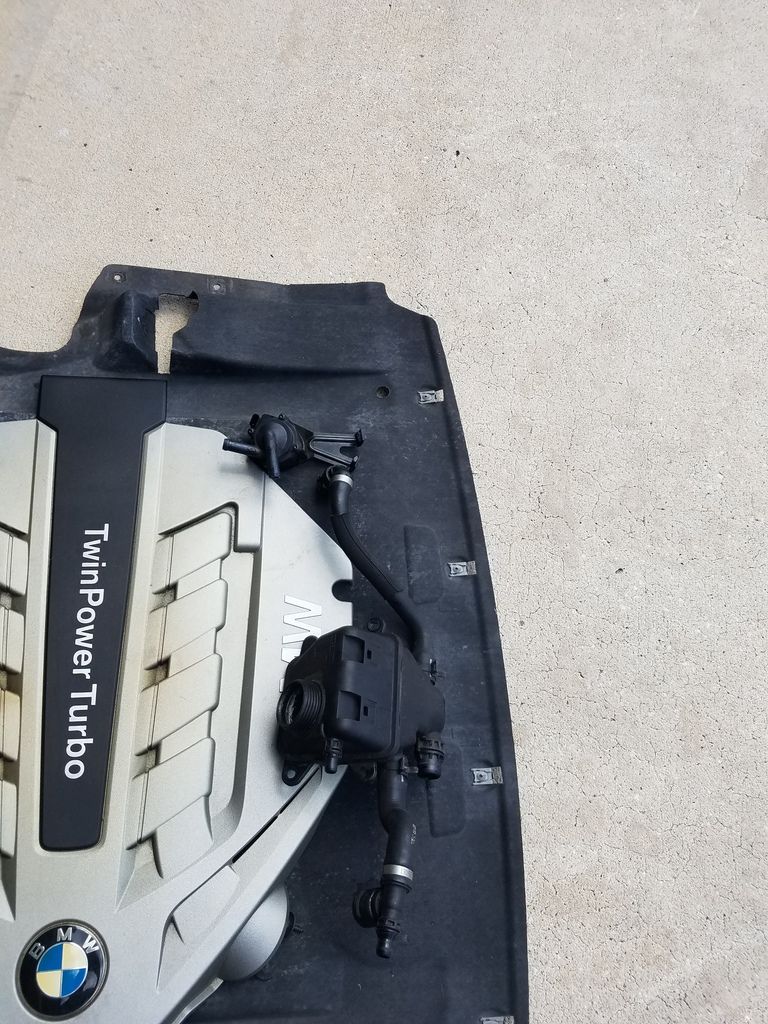

That intercooler reservoir will need to be removed. Two 7/16 plastic bolts hold the reservoir. All hose connections are clipped on. Remove all hose connections from the intercooler sides. DO NOT REMOVE THE PERMANENT CLAMPS ON THE RESERVOIR SIDE.
Driver side intercooler elbow comes off, the little hose from the reservoir comes off, and the passenger intercooler tee comes off. Then remove the large hose connection from the reservoir( this is tough, be patient.) the 90 degree dental pick is useful here to lift all the clips holding the connections to allow removal.
Now the reservoir out, remove the aux pump. Two torx T25 or 30 are used here. Remove them and undo the clamp with a flathead. The other clamp can be removed using a pair of pliers or needlenose. The electrical connector, be careful. remove it carefully.

Let the coolant drain out the hose to the bucket. There's a drain **** on the driver side of the radiator but you'll need a special large torx driver. Also, the drain is plastic and i'm scared that I'll damage it so no need for me to tamper with it. After drainage, remove the two accesible inverted torx bolts holding the thermo to the water pump. The last hard to reach one will have to be accessed through the bottom utilized with extensions and a wobbly. After removing all three bolts, remove the electrical connector and tap the housing using a soft drift and a hammer. The seal is tight on it so it will take abit to be successfully removed.

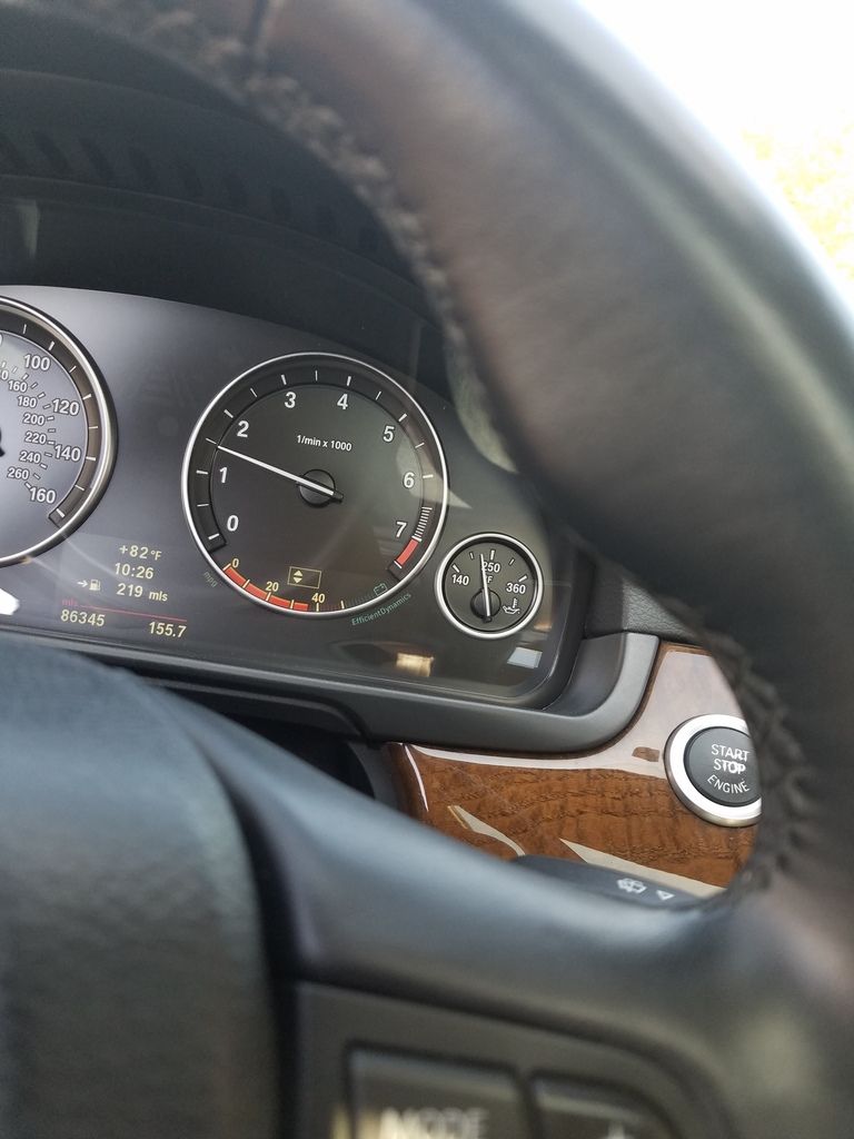

Basically turn the car on, hold the trip button and don't let go of it until the menu shows up. Then go to UNLOCK, put the code in which is the addition of numbers of your VIN. Then go to temperature and monitor from there.
Once it reaches 93C, then it should fluctuate between 92-93C. Then it will stabilize and go up to your true new setting at 96C. You'll know it is working since it won't spike suddenly after that. If it goes past 101C, something is wrong or you still have air.

Mines run at 96C now, planted. When I give more gas, it goes down to 95C and then Back up to 96C. When Idling, it went up to around 98 to 99C. This is okay since once I start moving, it goes back down to 95-96C. Also, being 90 degrees outside in sunny florida, this is a great improvement.
