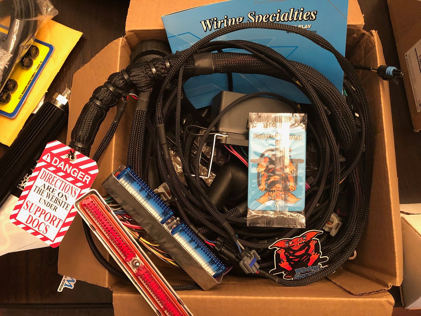

Here is the wiring harness. Wiring Specialties is awesome. Yes, it is possible to just create a wiring harness, but the fit and finish of this and the support they provide is second to none. I certainly couldn't turn out a product this good.

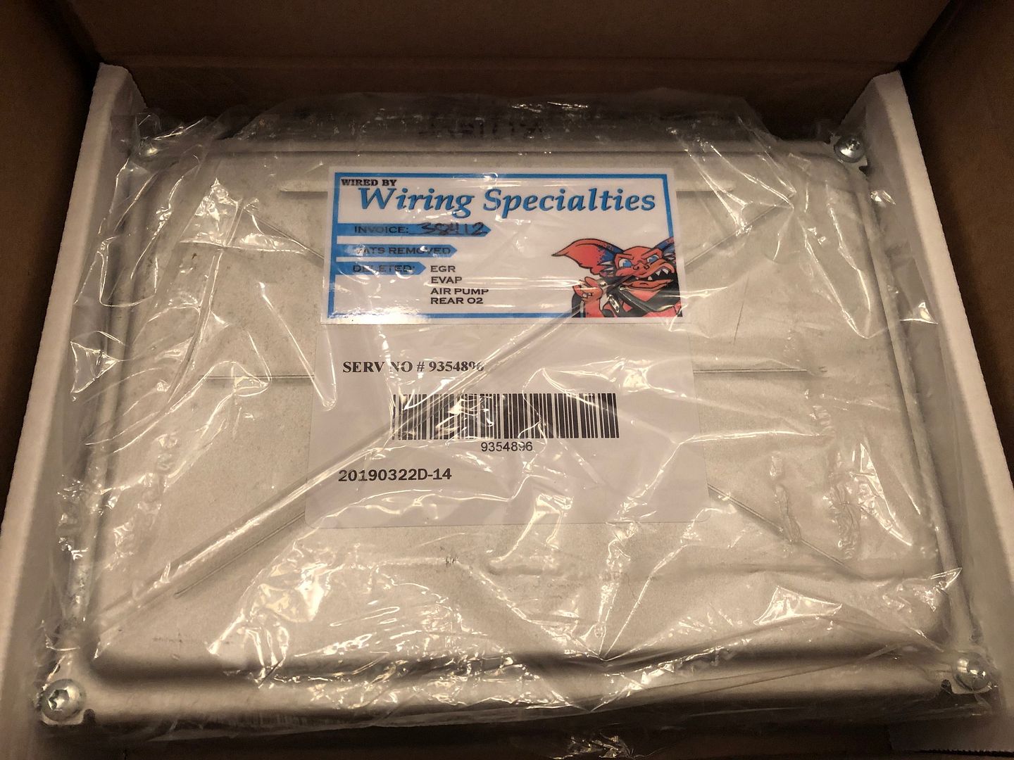

It also came with the PCM. Wiring Specialties has flashed this unit to adapt it to my exact specs (A/C w/GM Compressor, OBD2, etc) Super easy and actually pretty inexpensive.

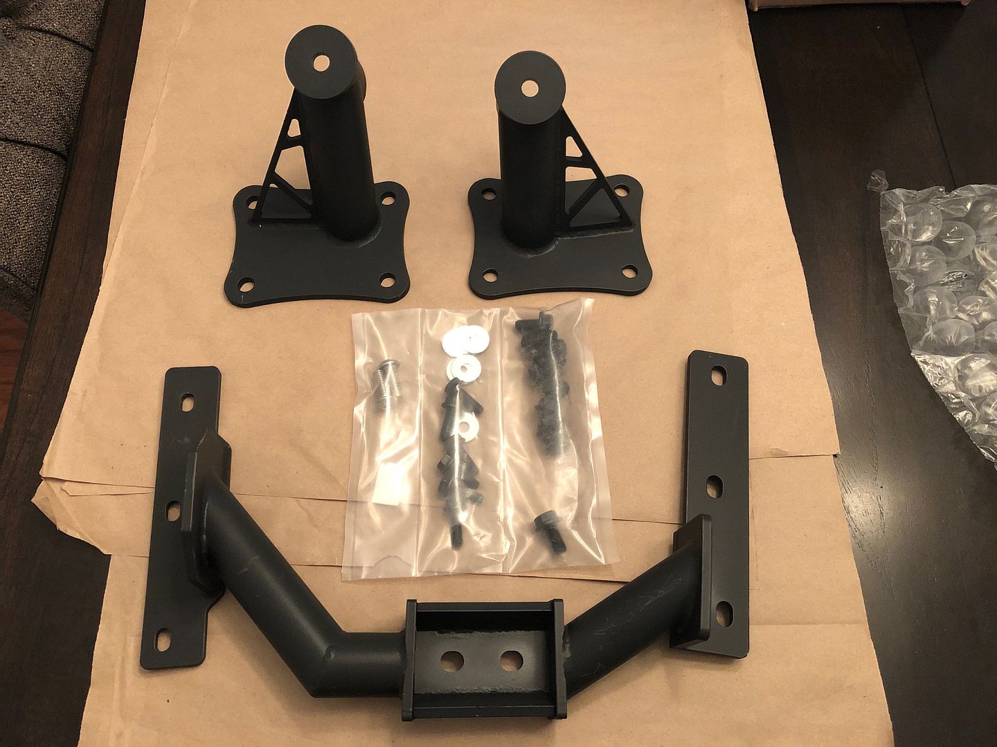

I decided on a set of "home made" engine mounts from a gent in PA. He also did the mounts for the McCrimmon LS/E36 and was nice enough to make me a set. These mounts are super solid and they use the stock engine mount pads for lower NVH.

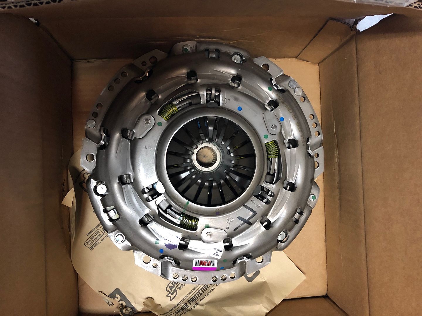

I decided on an LS7 clutch and flywheel. I don't intend to boost this engine or really pull much more then stock HP out of it at any point. I want a smooth daily driver. This kit is a stock GM part including flywheel, pressure plate, and new clutch. It should be good for about 500hp with no issue and still be smooth and easy to drive in stop and go traffic.

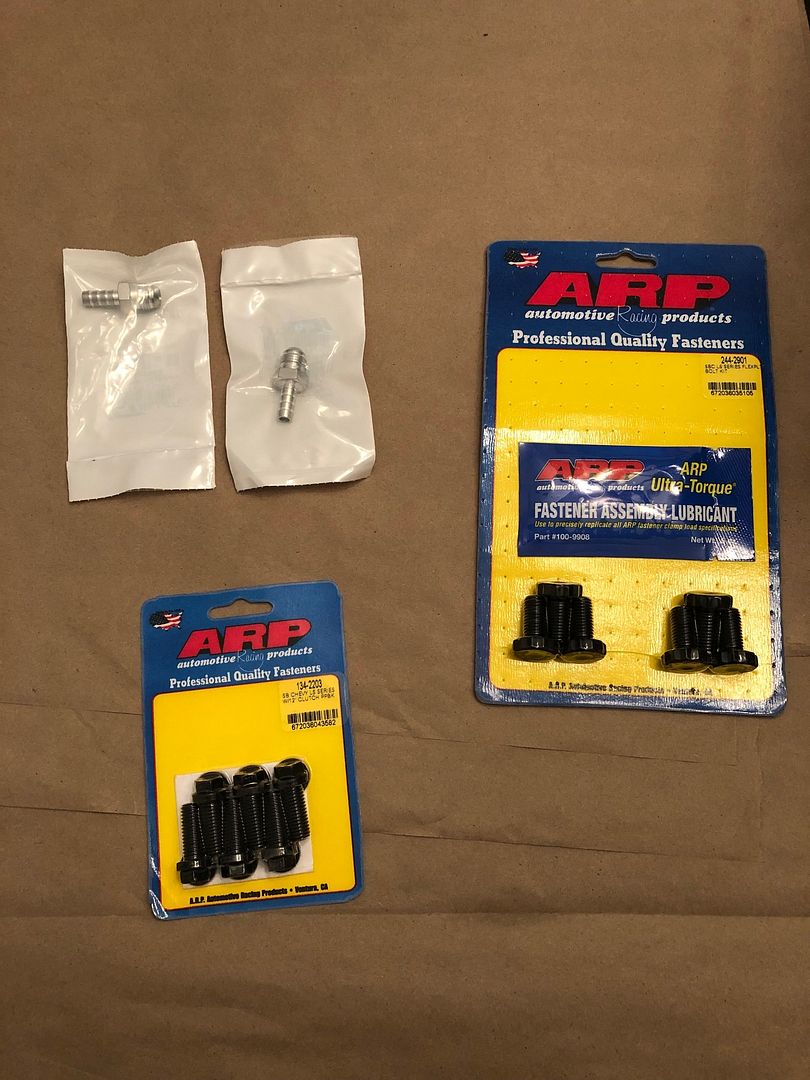

Although I am not pulling the engine apart due to it's super low mileage (35k) I will be upgrading all applicable external bolts to ARP. Here are the flywheel and pressure plate bolts as well as a few random bits for the fuel system.
