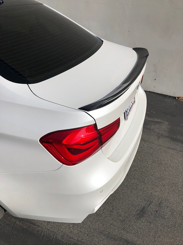

INSTALL: Before diving into 'install', lets talk uninstall of the OEM spoiler. F.M.L. What a nightmare. Bought 65lb fishing wire in an attempt to try and get spoiler and tape up off the trunk lid. All we did with the wire was cut through the middle of the spongy tape leaving 50% on the spoiler and 50% on the car. 1 hr later, a heat gun, 1 bottle of rubbing alcohol, a lot of shop towels, some goo-gone, and 3 blisters on my finger and thumb tips, we had a clean prepped surface to attach to. I'm sure some learned gent here will enlighten us on a better way to do this, as the removal of the OEM piece is by far the worst part of all of this.
THE KIT: The spoiler comes with enough double sided tape to do three runs down the length of the spoiler. The snobs out there can get your own tape, if needed, but i'm a few weeks in now, and a couple of runs in Mexico and the spoiler is still solid. We even had rain and it hasn't moved.
The spoiler itself required a little shaping where there was some rough and raised edges. A simple razor blade took care of this easily. There were also a couple of rough patches where it might have been taken out the mold or was scuffed before it was packed. The rubbing alcohol cleared some of these up. I'd say, if you are anal to the nth degree about these things, this isn't for you. But you already knew that, as you got the BMW M OEM one anyway. For average Joe looking for a CS style spoiler, you should be very happy. Only a concourse nerd will look for and see these issues.
After one practice run, we applied the three strips of tape to the bottom of the spoiler, took our shot, and landed the spoiler on the trunk lid. We held it down for about 3-5 mins. It was a pretty warm day and that was all it took.

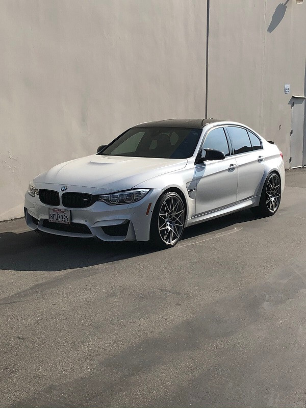

VISUAL IMPRESSIONS: I've always loved the CS and the CS spoiler especially. A chance to snap one up i couldn't resist. I honestly wasn't expecting too much with regards to the quality of the piece but can whole heatedly say i was very pleased. The weave actually looks great IMO. The style is spot on for CS style. Overall, a great piece of kit. It will be staying on my car indefinitely.
