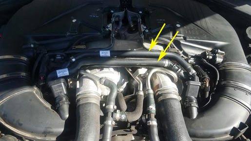

So prior to taking the car to a local dealership I detailing to them what the problem was with the vent line and directed them to the warranty extension of 10 years and 120K miles for the part and made an appointment.
First thing the Service Advisor says is that BMW says the part has a 7 year warranty and that my car 2013 650 is out of that warranty. This is why I hate dealership service departments. If I were John Q. Public, first I wouldn't have even known about the warranty extension and if I didn't know the details I would have "probably" been charged for the repair.
I told the SA that he was flat out wrong and to look up the actual document. So he did and came back with "Oh yea, the warranty is for 10 years, so it's covered.
Anyway the two lines were replaced and problem solved. See arrows:
