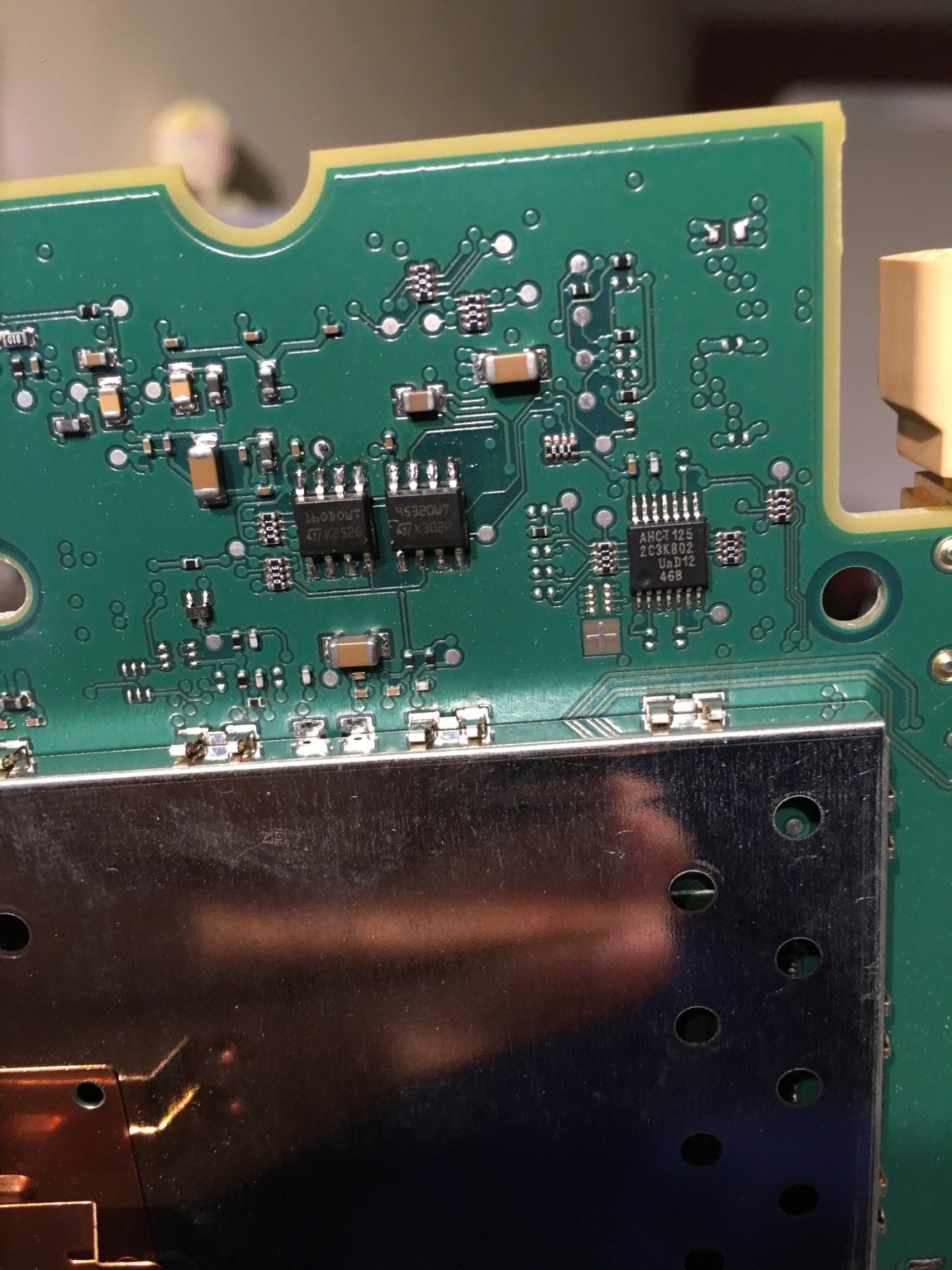

You need to Desolder EEPROM from motherboard in order to write new Data to it.
#431 ·
Once VIN and Mileage is blanked from EEPROM, you can install 6WB and Code it like any other ECU.
