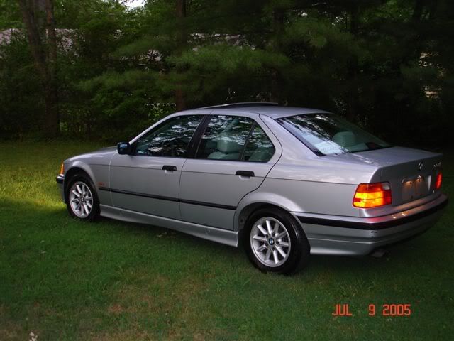

I have new (to me) 98 328i and the wheels have the stock wheels (not sure what you call them - please see pic) and the wheels are "spotted" with whitish spots. I am not sure how to get the spots off. I am particular about the things I use on my cars, but I also have a family to feed! ;)
Please suggest the best thing (homemade or bought) to get them back to their normal state of being that matte/shiny finish, instead of dull and spotted.

I only use P21S for wheel cleaning.This will be a good first step.
Once they are clean look at the spots real close. It may be chips in the clear coat.The big problem comes along if the aluminum "under" the clear coat has started to oxidize.
If thats the case, the only repair is to have the clear removed, the aluminum polished, then re clear coated.
A close up picture would help.

I will take some pics of the wheels in question. They are not "pitted", but they almost look like they have parts that have been stained a lighter color silver. They don't appear to have the finish removed, but they do look like something has happened to the finish.
Hopefully pics will help.

It could be that someone (dealer prep?) has used an acidic wheel cleaner and left it o the surface for too long. Very difficult t diagnose a problem without a photograph ( this is only a SWAG- scientific wild a** guess

Well, I read enough and felt that it was probably problem of the wrong kind of cleaner being used and they were "stains" that MOTHERS could handle.
Spent the $3 on a can of Mother's polish and an hour later - my wheel look INCREDIBLE! Still not exactly sure WHAT the stains were, but they are now NO more...
