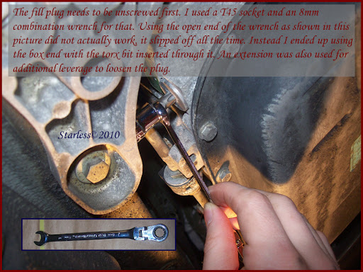

First thing to do was to unscrew the fill plug. I used a T-45 socket and an 8mm combination wrench. The torque of this plug is 15 ft. lb (20nm), so using the open end was not enough to loosen it up, it kept coming off the torx bit. But I was successful with using the box end of the wrench inserted onto the torx bit and an extension for the additional leverage. The drain plug (T-40) presented no problem to unscrew, so in 10 minutes the oil was partially drained. Some still remained in the pan and inside the filter. At this point I put the drain plug back in and torqued it to 15 lb. ft. The next step was to remove the pan (unscrew all the bolts using a 10mm socket and pry it with the flat screwdriver if it's stuck), let all the remaining oil drip into the pan, remove the filter by pulling down on it with both hands, drain the oil in the pan and inside the filter into the drain container for the final estimate of the amount of evacuated oil. A note on the condition of the drained oil. The old oil was not completely black as many report. Definitely looked like a used oil after 85K but still retained some of its golden brownish color. If you compare it to a bright red AFT like Dex III or VI, it does look bad, but comparing it to fresh 8072B the difference is not that dramatic. I'm not sure about lifetime, but I got the impression it could easily last till 100K when BMW recommends it to be changed.

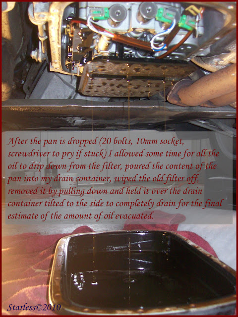

The amount of oil I was able to evacuate is as follows. The car was absolutely cold when I was doing the procedure. About 1.5 L drained after opening the fill plug. About 2.5 L came out with the drain plug removed. That's 4 liters. 1 litre was in the pan after I dropped it and waited till all the oil dripped into it from the filter. That's 5 litres. The old filter still contained about 0.25 L of oil when I removed it and tilted in the drain container. So the total amount was 5.25 L of oil.

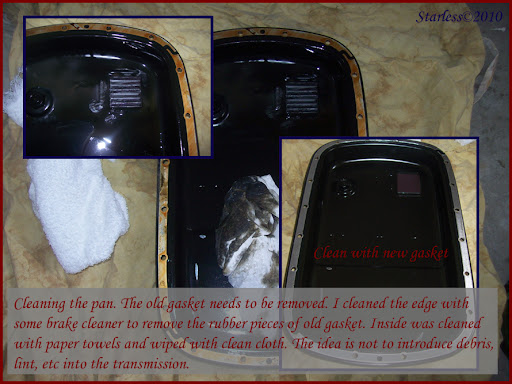

The pan needs to be cleaned thoroughly. Mine did not look awful after 85K but still needed a good cleaning job, especially around the magnet. I used paper towels and a rag. When I removed the old gasket there was some rubber stuck to the edge of the pan. I removed it with some brake cleaner and then wiped dry with a rag. The idea is to not introduce any debris, lint, etc into the transmission.

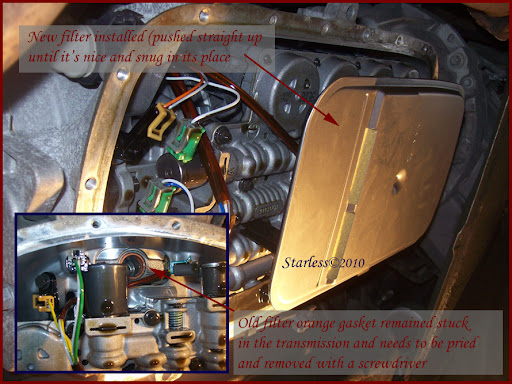

It's time to replace the gasket lubing it with some ATF and start assembling everything back together. First goes in the new filter. When the old one came out the orange sealing ring is likely to have remained stuck in the transmission in which case it needs to be pried with a screwdriver, removed and discarded. With the new filter in place reattach the pan using new bolts. The torque of the bolts is 8 ft. lb, so there is hardly any need for a torque wrench but I did return to each bolt at least 3 times to make sure everything was tight.
