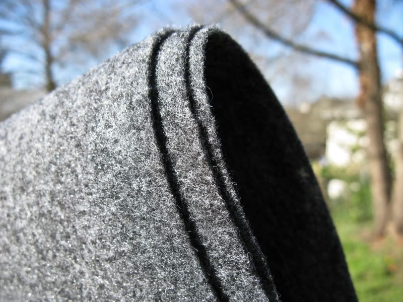

I found this synthetic felt at Jo-Ann Fabrics, and it's pretty much an exact match to the material BMW used in the trunk at the factory. Score!

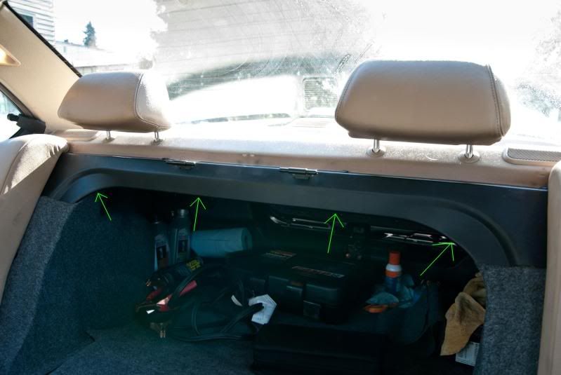

The offending item; this trim piece was the source of so much creaking! As mentioned above, remove the side bolsters by prying them off with your hands from the top.

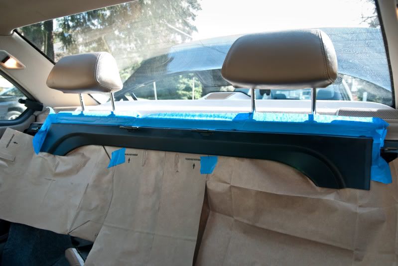

Step 2: Mask off entire surrounding area. You don't want any glue over-spray. Also, after I took this photo, I realized that I hadn't masked off the seat back retainer clips. Don't forget these!

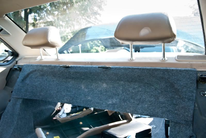

Step 3: Beginning with the top edge, carefully glue the felt to the trim piece. I did about ten inches at a time until I had gotten to the other side of the car. Then with the top of the felt anchored, I lifted it up from below and began gluing the main flat surface from one side to the other in stages.

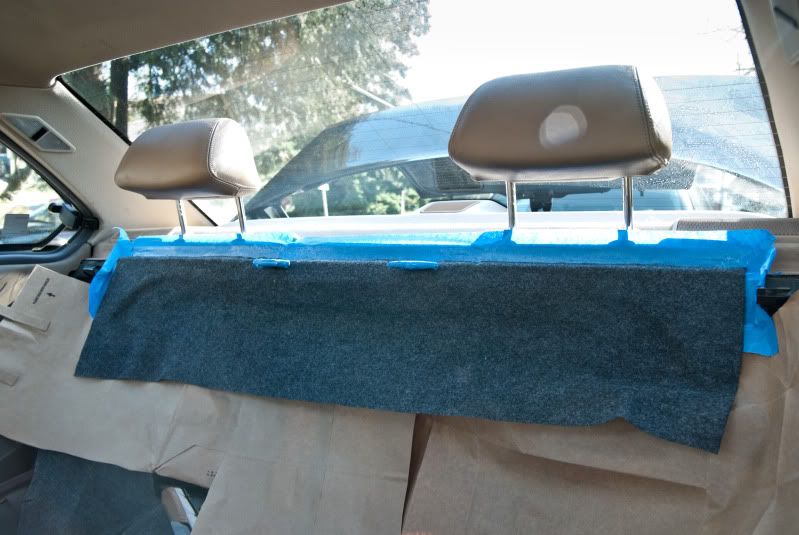

Step 4: Everything is now fully glued. Remove masking.
Step 5: Trim off excess material by running along the lower edge with a sharp razor.

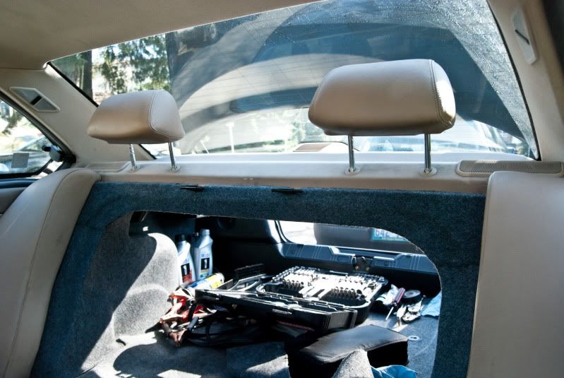

Step 6: Reinstall the side bolsters and you're done! Only the most discerning E36 nut will be able to recognize that it isn't OEM.
Step 7: Drive in silence! No more rear parcel tray creaks!
