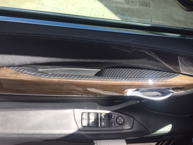

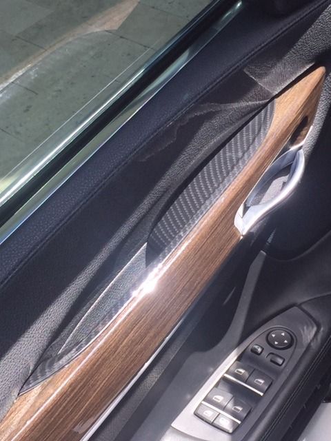

Any help is appreciated, my driver's side door handle is melting, at first I thought there was some "tar/goo" on there, but no it's actually melting as I bought some goo-b-gone and it kept scrapping away.
I really don't care about replacing it unless I can replace just the interior plastic part, but I would like to stop touching the tar as it messed up my oyster interior, spots will go everywhere.
Is there some type of spray that would "seal" it? I can tape up the surroundings and spray paint it or something?
