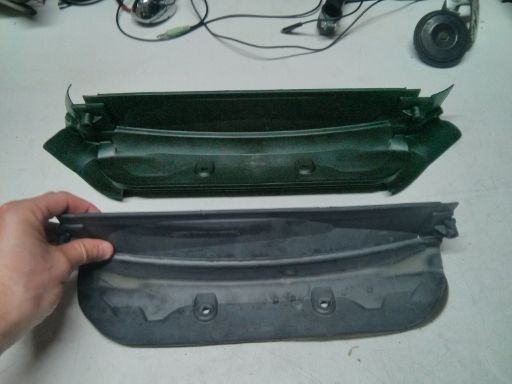

The issue with injector #5

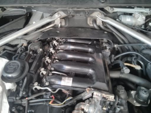

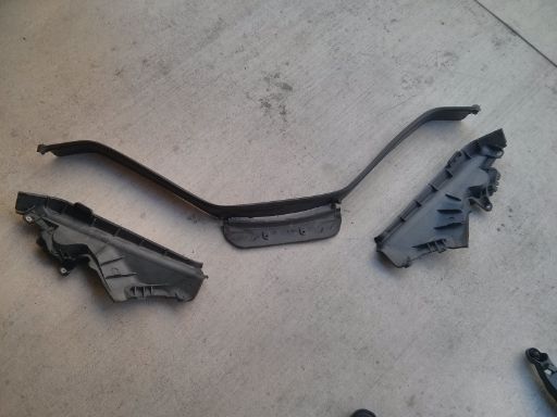

Today I decided to take the partitions apart and replace it.
Here's how they looked: all 3 were broken along the seam
I called the parts department at my local dealer and the conversation went something like this (I have a very good relationship with the parts department and have been doing business with them for quite a few years):
Me: "Hello it's me. I need part number A, B and C"
Her: "Are those the partition in the X5?"
Me: "Yes they are, great guess"
Her: "Oh we stock them because they break all the time"
Me: "I'm not surprised. If you could, would you be so kind to check with your techs if there's any sort of SIB on point?"
Her: "Sure, I'll call you back"
15 minutes later
Her: "No, their is isn't they just replace them"
So there it is: very common issue, but no SIB

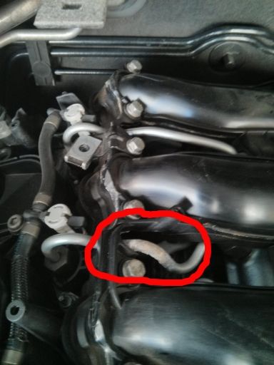

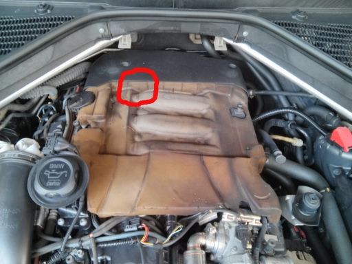

In the meantime I decided to take it apart and discovered why this issue ends up causing issue with injector #5.

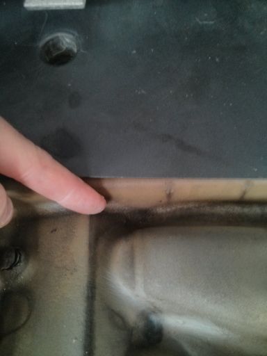

Although above the engine there is a bunch of stuff it all sits in front of the black plastic cowl you see in the back on the engine so it really doesn't add any protection. Moreover there is a sound proofing foam right over the engine that is exposed between the cowl and the airbox and it can easily act like a sponge. It is contoured so it is in contact with whatever is underneath. Last but not least there is a valley in the contour where water accumulates.

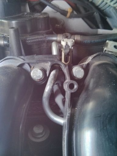

And guess what is right under that valley? Yes, injector #5!!! In my case I discovered corrosion on the fuel line of injector #5 going from the fuel rail to the injector pump. Right below the fuel line is where the connector is.
What I decided to do is remove the foam: it is technically a sound proofing foam, but I honestly didn't notice any change in noise. This way water should flow if it ever gets there.
Now lets go back to the partition. It is such a royal piece of $hit that I went pick up a new one that was already cracked so I had to return it. But it appears that someone has noticed the flaw: the center piece is not made of compressed vomit but plastic and is much more robust: it still retained the same part number. Also noticeable is the different gasket profile.
Tomorrow I'll go back pick up the new side that was broken but I'll ask to investigate if maybe that is some old inventory... Stay tuned!!!

Part that fails prematurely? - an updated part has been supplied for quite a while already.
In my case the only part that had different design is the center one; the other two pieces are the same as the old one. Where they all three supposed to be different?
My dealer doesn't have anymore in stock so he had to order a new one: we'll see when I comes in of maybe the new inventory has the same design of the center part.
