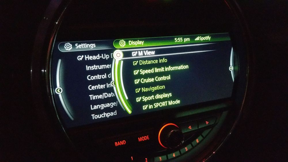

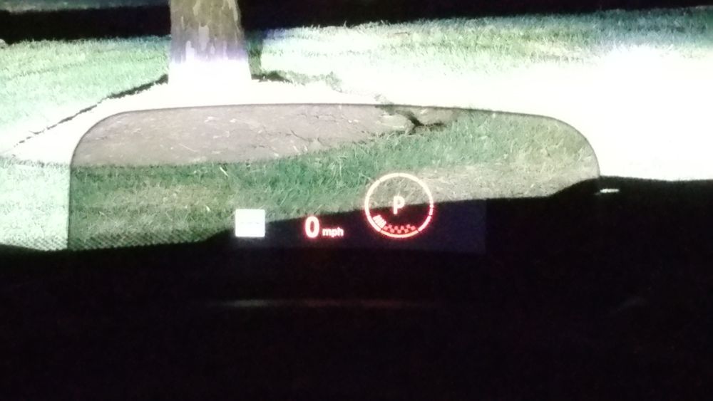

DISCOVERY NUMBER 1
Enable JCW Tachometer in HUD
Requirements: F-Series MINI Cooper or Cooper S, Heads-Up Display. Probably also requires Visual Boost.
This will probably work on any F-Series vehicle with a HUD. I cannot make any promises, but as long as your software has the commands below, it should work.
Go to HU_NBT_EVO (I cannot help if you don't have HU_NBT_EVO, but I would suggest looking for similar terms).
Under 300C > HUD, set HUD_SPORTANZEIGE_ENABLE, HUD_SPORTANZEIGE_FES_ENABLE, and HUD_SPORTANZEIGE_MS_GASSE_ENABLE to AKTIV.
(Alternatively, it may be possible to use "300C > HUD > HUD_M" and set that to ACTIV. Turning both on creates menu items in the HUD menu for M View and Sports Gauges; Sports Gauges gives more options.)
Next, go to KOMBI and under 3003 > FZG_Aussttang, set HUD_SPORTANZEIGE_ENABLE, HUD_SPORTANZEIGE_FES_ENABLE, and HUD_SPORTANZEIGE_MS_GASSE_ENABLE to AKTIV. I also enabled HUD_FAHRSTUFE_ENABLE - but I'm not sure what that does.

I don't speak or read German but I do have Google Translate. My guess is that the three commands that are shifted to AKTIV are for the three options in the HUD menu:
  • Sports Display
    • In Sports Mode
    • With Shifter in S
This is based on Google Translate. FAHRSTUFE is translated as "Gear" - so it probably is the gear indicator in the HUD.

Hi! I just saw this and it was extremely helpful. Just tried out in my JCW 2019 and works perfectly fine. JCW has already enabled the sports display on HUD, however you can only see the gear when gear selector is in manual or sport, otherwise there is an empty spot in the middle of the rev counter.
I wonder if there's any way to show the actual gear number while gear selector is not in sports mode, something like VAG does (D1, D2, D3). Has succeeded in coding that?

Nice: so the M-View gives you the speed, speed limit, tachometer and gear like on M cars. I wonder why the checkbox is not on by default.
Well, actually, I'm not sure about that. I know that the "Sport Display" allows those to be shown and that "Sport Display" and "M View" turn on at the same time (they're the same function, different name).
I'm going to remove M View from my coding, however, since it doesn't offer anything (actually, it offers less than Sport Display because it doesn't have the conditional options). Having the Sport Display/M View active, at least in my 2016 F55, turns off the Navigation in the HUD - there's no more space for it, I'd say, and unless I'm in Sport Mode or M/S, there's no need for an additional tachometer (keep in mind that F56-series MINIs can use the Center Instrument (the circular led display) as a tachometer as well).
